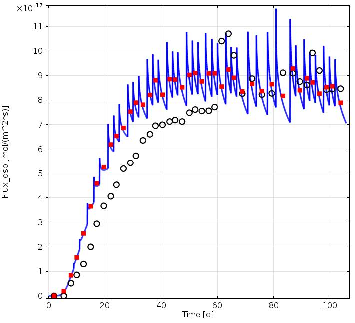

I followed your recommendations and suggestions and I got exactly the result I wanted. In the attached figure you can see the outcome of a first preliminary calculation: Using black circles there are shown the experimental flux data at the downstream boundary of a tracer through-diffusion experiment through compacted clay. Each data point has been averaged over the sampling interval and the value is allocated to the mid-time point of the measurement interval. The blue zigzag line describes the (computed) diffusive flux when accounting also for the experimental sampling procedure, and the red squares denote the calculated averaged flux data allocated to the mid sampling intervals, too. Hence, a direct comparison between experimental data and modelling results is feasible.
With such a Comsol set-up it is possible to account in detail for additional information of the experiments which helps reducing uncertainties in the analysis. (Note: The model’s parameters have not been optimised yet.)
