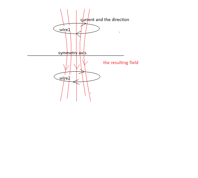

I have two identical wire loops placed above each other. The symmetry axis is in between them. The direction of the current on both wire loops is similar, so the resulting gradient of the magnetic field from one wire is amplified by the another wire. Thats the idea. The surrounding material in the region is air, and the material of the wires is copper.
This is only analytical setup, and this not going to be build in a real experiment.

Mikhail,
a couple of comments to your model from a more physical point of view. Your drawing looks like a Helmholtz coil. So the two coils will not increase field gradients, they will decrease them. Helmholtz coils are known to produce particularly uniform fields. You will see that in the simulation when you compare a single coil to the two coil arrangement.
I don't see the purpose of the symmetry axis. Nothing in your setup is symmetrical regarding this axis. In an axisymmetric 2D model, as proposed by Ivar, the symmetry axis must extend through the centers of the coils.
If you need strong gradients you would rather define the currents in the two coils in opposite direction.

Posted: 1 decade ago 2013/02/13 9:14 GMT-5
The "symmetry axis" I called its the axis, to define simply the position of the coils, so it would be clear, that the wires are positoned exactly above each other with a variable distance. I know that there is no such physical symmetry in this model.
The idea of the current direction came from a problem I tried to simulate some time ago with another tool (didn't have access to COMSOL at this moment). In the problem I have two permanent magnets, exactly above eacht other and with different assignments of poles. It was a 2D problem, they were positioned along y-axis. The first magnets hat the poles North in +y direction and South in -y direction. The second magnet had the South pole in +y, and the North pole in -y direction. The resulting field eliminated each other in between.
But anyway, the purpose of this try in COMSOL is to build one simply model, and then playing with parameters such as current direction to get different results. Later on I will try to add to the model more wires along the x-axis. So in the end there will be like four 1 turn wires in +xdirection, on same y-coordinate, and below them exactly the same number of wires on a different y-position, but on the same x-position as the above wires. And the interesting result is the field in between the wires.

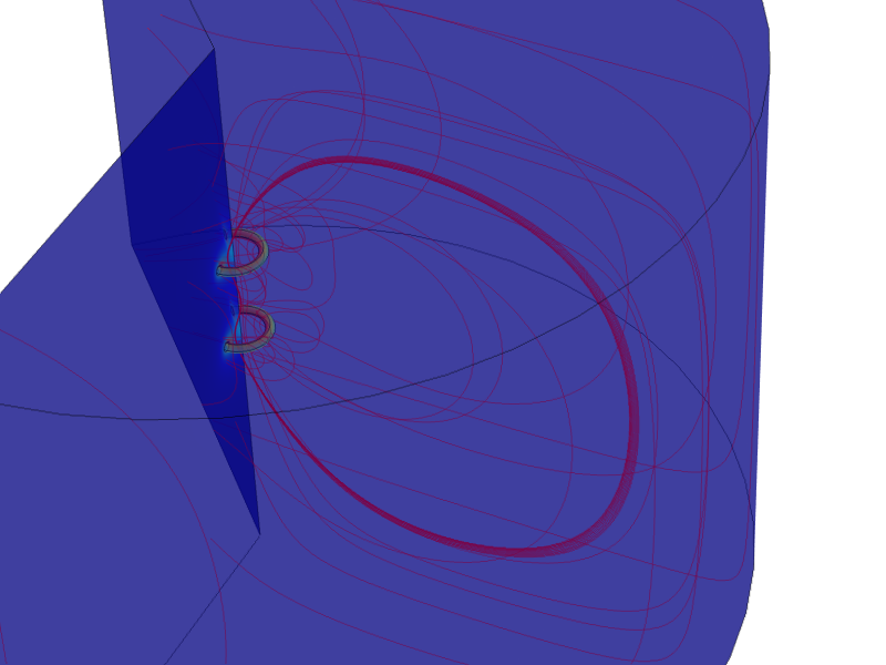

Posted: 1 decade ago 2013/02/14 6:24 GMT-5
Hello again, thank to you all, I've managed to do exactly what I wanted.
I've attached a screenshot from the 3D view of the coils.
Now I am going to add more parallel coils along the z-axis. This is going to be a bit tougher, since I can't use the symmetry. So I guess I should drawing the coils in 3D.
Hello again, thank to you all, I've managed to do exactly what I wanted. I've attached a screenshot from the 3D view of the coils. Now I am going to add more parallel coils along the z-axis. This is going to be a bit tougher, since I can't use the symmetry. So I guess I should drawing the coils in 3D.
