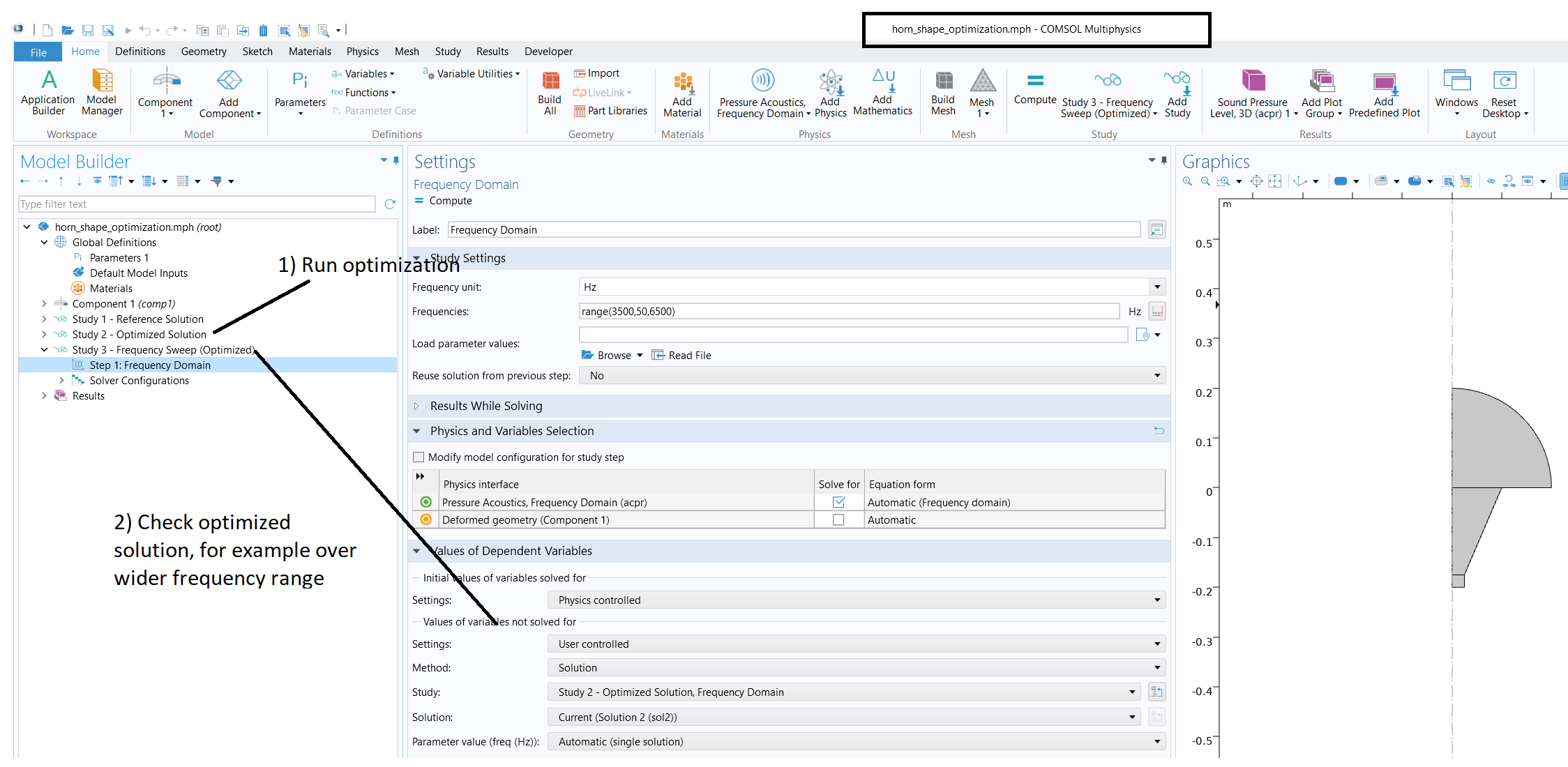

You can see an example here from the acoustics module. The principle should be the same.
