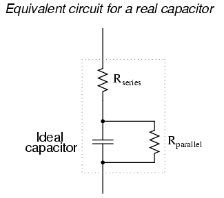

I am having trouble modeling something. I would like to look at the conduction/conductance/resistivity of a insulating/conductive composite. It could be thought to be like a polymer/insulating fiber system. Electrically, the polymer itself is referenced in literature to look like a capacitor and resistor in parallel. The capacitor illustrates the ideal dielectric capacitor that one might expect and the resistor illustrates the leakage that actually flows through the capacitor when placed in a potential. The illustration is on Tony Blythe's 2nd edition "Electrical Properties of Polymers" book on page 156. I've attached an image of the equivalent circuit I am talking about(not exactly the image from the book though).
I would like to know the DC electric conduction through the entire composite, so both in the low conductivity areas (the polymer/semi-insulator) and the in the high conductivity areas (which is a fiber/metal). Is there any way I can use components of both the Electostatics and Electric Currents Modules? I want it to take into account both the electrical conductivity and also the relative permittivity of the polymer. If so how can I do this? I've attached a 2D model of the geometry of what I'm talking about.

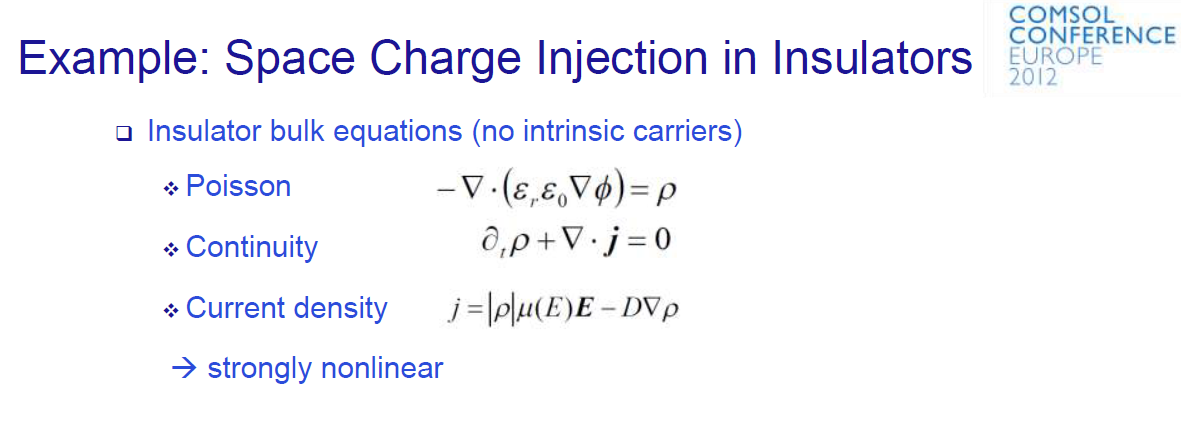

I am beginning to get the hint that the EC is not for insulators or semi-insulators, but how is one supposed to model a (not completely) insulating material, then? Seems to me that there is an option for if the charges are static (ES) and then if the material is > 0.1 S/m you can have a current with the EC. Is there any option for anything in between? Or is there any kind of option for connecting them? I'm sorry if this question is completely naive.
I noticed in a presentation by Christen on the Comsol Conference that uses the Poisson and Continuity Equation together. I've attached a screen shot of the slide. Is there any way I can attach an equation to the ES that will allow for a little bit of current to flow? Maybe this suggestion is completely off base, but I am just trying to figure this something.

I would say that in your model with the copper conductivity of 6e7 S/m and the nylon with 1e-1 S/m it IS just a little bit of current in the 'insulator'. You have 8 orders of magnitude in the model. You could try now to tweak the solver to increase the span.
Which specific question to the model remains unanswered? I don't think the publication you cited is applicable to your question.
