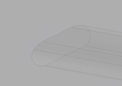

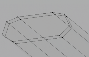

I have an electrode around which I put an air cube to simulate the e-field. I noticed that the last "Form Union" in the geometry node makes the previously curvy electrode full of edges, distorting the simulation results. I tried to adjust the repair tolerance to the smallest available value without success. Is there another way to keep the resolution of the geometry?

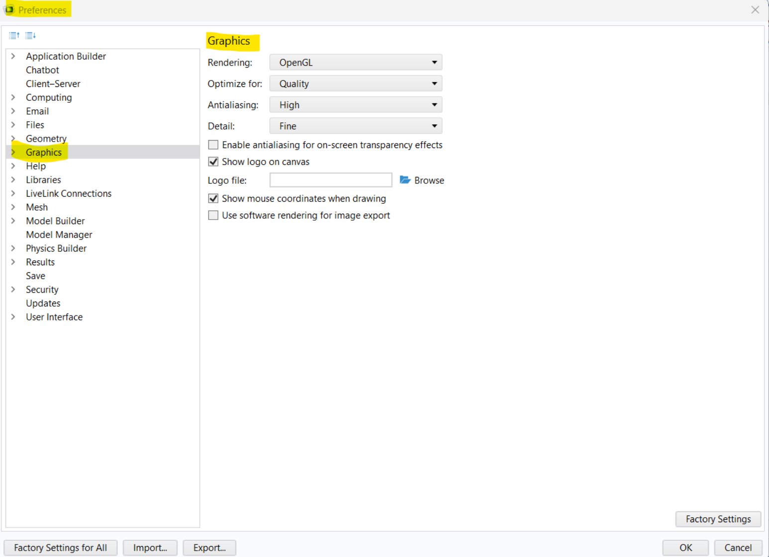

another advice from the support center that may help: changing graphics settings
