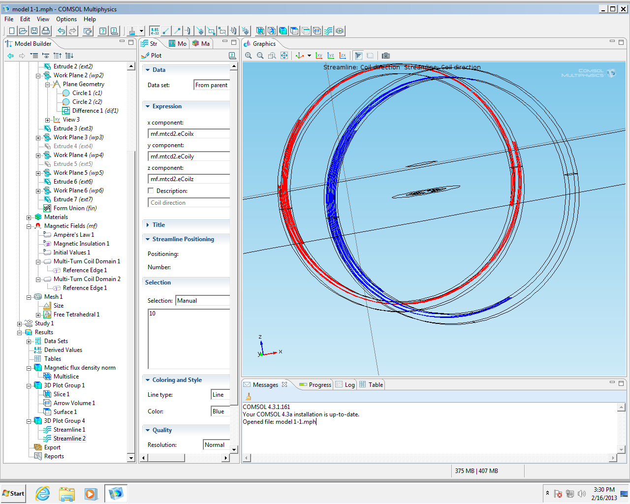

it looks like you used a geometry parameter for the components of the flux lines. You must use the magnetic flux density components instead and assign proper start coordinates.
Cheers
Edgar

I have attached my file below. What I did for this model is I have a mesh for the Helmholtz coil and one for the permanent magnet(zone 7). and I also have another setup to generate another magnetic field below the permanent magnet(I disable that for now). Can you check the parameters and properties I choose for both the Helmholtz coil and permanent magnet? The plots for these model is really important for my research. Thank you for you help!
you should start to use only 1 MF as now you solve for two magnetic vector potentials over the same model, but these are not linked
Yes Ivar is right. I moved the permanent magnet's Ampere's Law into the first mf model (where the coils are defined) and it looks good to my taste. I assume you want to see the interaction between coils and magnet?
Cheers
Edgar

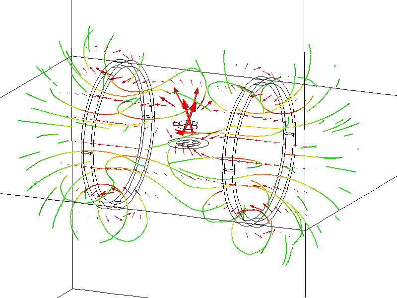

I have modified your model; is this what you are looking for?
Ralf
Sorry for the late reply. and YES! it is what I am looking for (by looking at the .png picture). but somehow, when I opened the mph file, i can't see anything in the graphic. Do you know why?...... and also, what changes you have made to the model to make it looks like this? Can you also explain why? Thanks a lot!
Celia
You have to solve it again; the model is clean (deleted mesh and solution to keep the file small).
As Ivar said I use only one MF physic to define all things.
Look at the 3D plotgroup 2 how the definition of streamlines is used (also limits for data range and color...).
Ralf
I resolved the model as you said and now I got the graph you did. it look good! thank you!

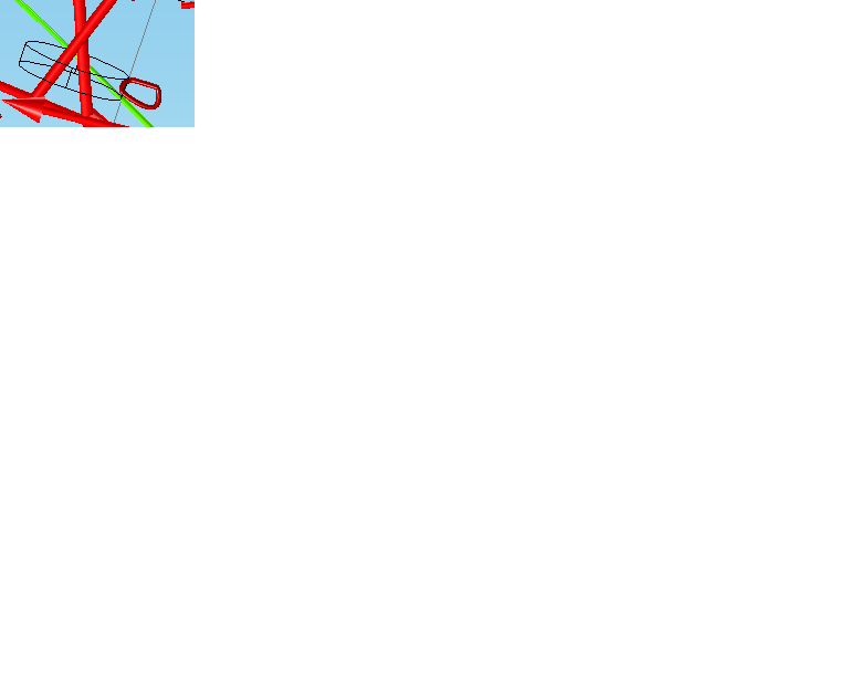

and also, what is the little circular thing attach to the cylinder in the middle? (i have attached a screen shot of it)

The little ring is one streamline. Since you have a strong magnet and a little coil current, the field from the magnet is much stronger. My streamlines depend on field strength...
If you increase the currents from 5 to 50A, you will see better images. Play with streamline parameters - you have several options!
