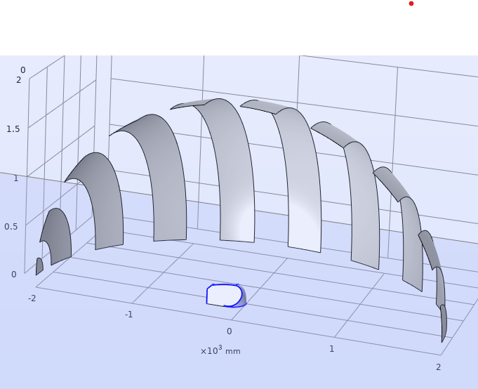

I try to evaluate a loudspeaker in 3d, axissymmetry is not possible due to changes to the model that will come.
I have been able to solve the problem in a 2d axissymmetric model. I evaluate the sound pressure level in points in a 2 m radius around the loudspeaker.
In 3d the fem model became too large and ran out of ram.
Now I need to set up a 3d evaluation with bem.
I have tried to mesh the points and lines (when rotate) around the loudspeaker and use the average nonlocal coupling to evaluate pabe.Lp. i have also given these points air as material. Unfortunately the sound pressure level is not correct as it is constant and does not change with frequency.

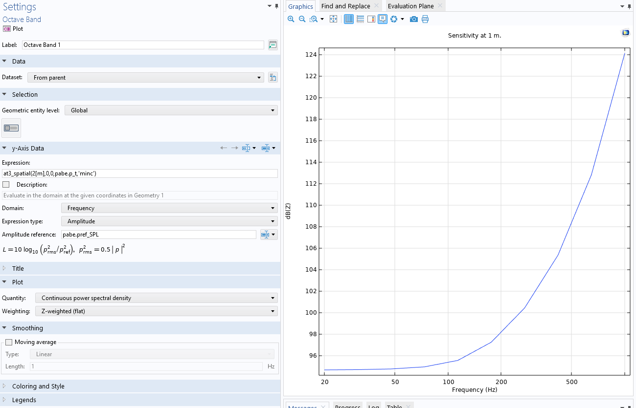

When I evaluate - Expression: at3_spatial(2[m],0,0,pabe.p_t,'minc') as 1d plotgroup and as octave band it works. It is the correct solution (same as in FEM 2d axissymmetric solution)
When I evaluate at3_spatial(2[m],0,0,pabe.Lp,’minc’) as 1d plotgroup in a global evaluation it does not work in any combination.

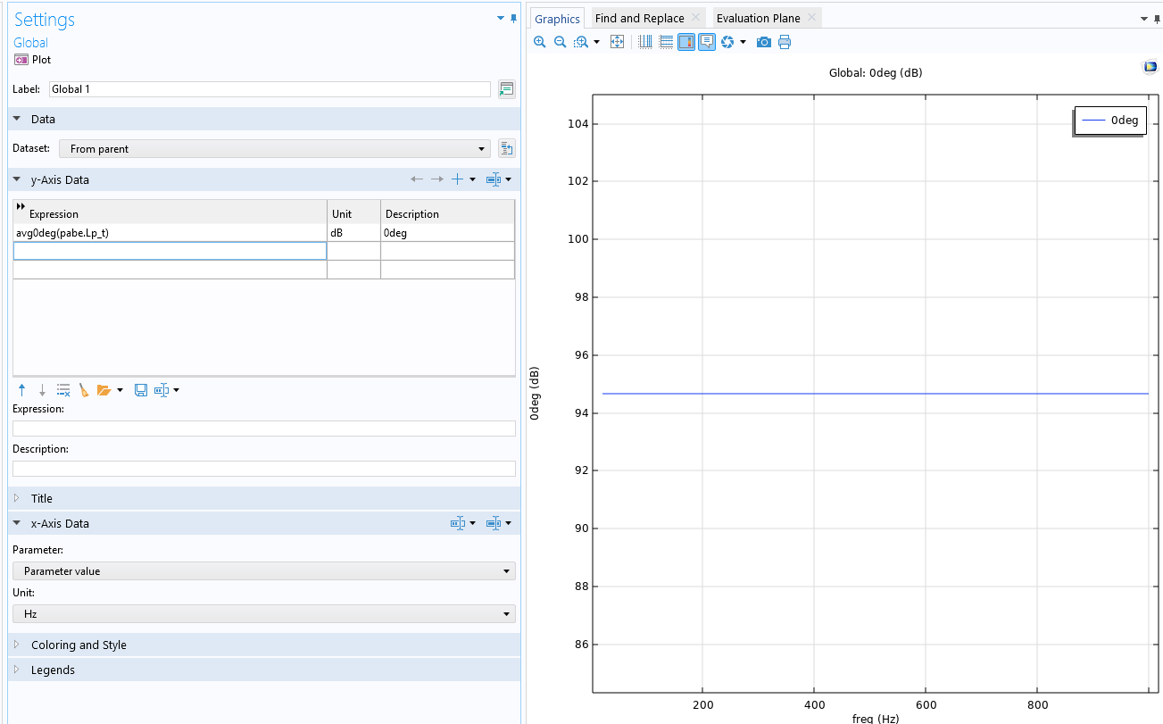

Evaluation avg0deg(pabe.Lp) gives me a flat line though it should be the same as the octaveband.
