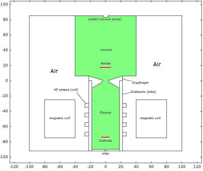

Unfortunately I didn't understand ...! didn't know how to solve this problem! My model consists of Plasma module and Lamir flow. My mass flow rate 1e-7 kg/s.
Inlet thickness 2 mm.
how can I add a mass flow rate?

Posted: 1 decade ago 2013/03/12 4:42 JST
first of all, in 2D-axi you should have no geoemtry on the r<0 side of the axis, only the cut line along the r=0 symmetry axis.
if you have an flow rate of [kg/s] this should be intop1(2*pi*r*u,rho) over the inlet, as "r" is in meters, u in [m/s], rho in [kg/m^3] and the dr of the integration argument (implicit not written out in COMSOL) adds a "m" hence you have
m*m/s*kg/m^3*m = kg/s
, no ?

Posted: 1 decade ago 2013/03/12 5:25 JST
yes! I understand it! this is not problem!
Problems another! how I can to add mass flow rate integration when I dont know velocity (u)? I just know mass flow rate=1e-7 [kg/s]
if I add the integral as a variable, I need to know the velocity (u).
density changes with time in the chamber.
how can I achieve a concrete mass flow rate?
how can I add 1e-7 [kg/s] ?
thanks...
yes! I understand it! this is not problem! Problems another! how I can to add mass flow rate integration when I dont know velocity (u)? I just know mass flow rate=1e-7 [kg/s] if I add the integral as a variable, I need to know the velocity (u). density changes with time in the chamber. how can I achieve a concrete mass flow rate? how can I add 1e-7 [kg/s] ? thanks...
Posted: 1 decade ago 2013/03/12 16:28 JST
but if the gas is entering in laminaire mode a parabolic profile is quite usual, then you have fixed values.
However you can also add a dependent variable: the local input velocity field across the inlet, and bind it through your fomula to impose the total flux, then COMSOL will adapt it "in a means square" approach
u(x,y,z,t) defined such as => intop1(...) - 1E-7 = 0
where the =0 is implicit in the COMSOL notation
