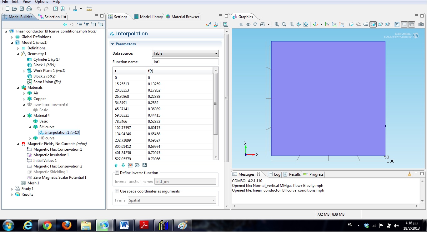

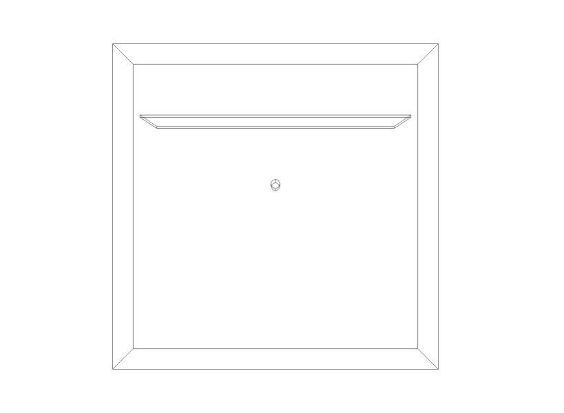

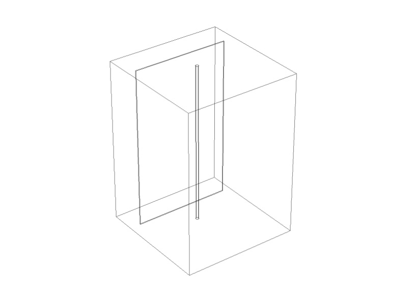

I have a 3D sim, A current line that generates my field and a mumetal infinite plane(1m*1m*0.5mm)
The 0.5mm is the thickness of my mumetal. I have 0.5T on the surface of the shield and i want to see the B behind the shield.
a.I use relative permeability constant at 7000.
b. I use a non-linear equation with saturation for relative permeability
μr= 1+[(μrmax-1)^(-1) + (μ0*/Η/ / B_sat)^(1/n)] ^(-1)
where mu_rmax=7000, B_sat=0.7T and n=1
c. I use the B-H and H-B curves filling them with my data curves.
Am I correct in any way of these models or I need some refinements to be more precise;
I can see the saturation and the B-H curve; How we can change the scales from a plot in comsol;
Also I attach some photos of my model.
Thanks in advance.

first of all, isnt it easier to model that as a 2D cut view (independent of Z) with out of plane flow (Z) of the current, in 2D
Hi first of all, isnt it easier to model that as a 2D cut view (independent of Z) with out of plane flow (Z) of the current, in 2D -- Good luck Ivar

Hi Ivar, thank you for your reply.
I'll try the 2D cut as you said! I have no problem with the 3D run time sim.
When i use the non linear relation for μr in 3D i receive a n error window....and when i use the BH-HB curve i've got the same result just as the model with μr=const=7000 .
I didn't understand extactly the second part of your saying about the without current flow on z? You mean that when i use the 2D cut this is an option of the geometry?
Thanks again!!
Hi Ivar, thank you for your reply. I'll try the 2D cut as you said! I have no problem with the 3D run time sim. When i use the non linear relation for μr in 3D i receive a n error window....and when i use the BH-HB curve i've got the same result just as the model with μr=const=7000 . I didn't understand extactly the second part of your saying about the without current flow on z? You mean that when i use the 2D cut this is an option of the geometry? Thanks again!!
Posted: 1 decade ago 2013/02/19 14:54 JST
Indeed, in 2D you can have current flow along Z the perpendicular direction, or in plane along a combination of X.Y
It's just easier/quicker to debug in 2D, then run a 3D model. For the BH have you checked the Model Library files with saturation iron cases, that gives you the indications how correctly map in the non-linear B-H mode
Hi Indeed, in 2D you can have current flow along Z the perpendicular direction, or in plane along a combination of X.Y It's just easier/quicker to debug in 2D, then run a 3D model. For the BH have you checked the Model Library files with saturation iron cases, that gives you the indications how correctly map in the non-linear B-H mode -- Good luck Ivar

Hi Ivar ,
I didn't see all the models at the library but I'll ckeck it out...and I'll inform you about my progress.
Thanks, for your time!
Hi Ivar , I didn't see all the models at the library but I'll ckeck it out...and I'll inform you about my progress. Thanks, for your time!
