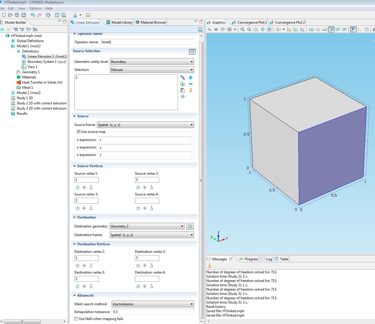

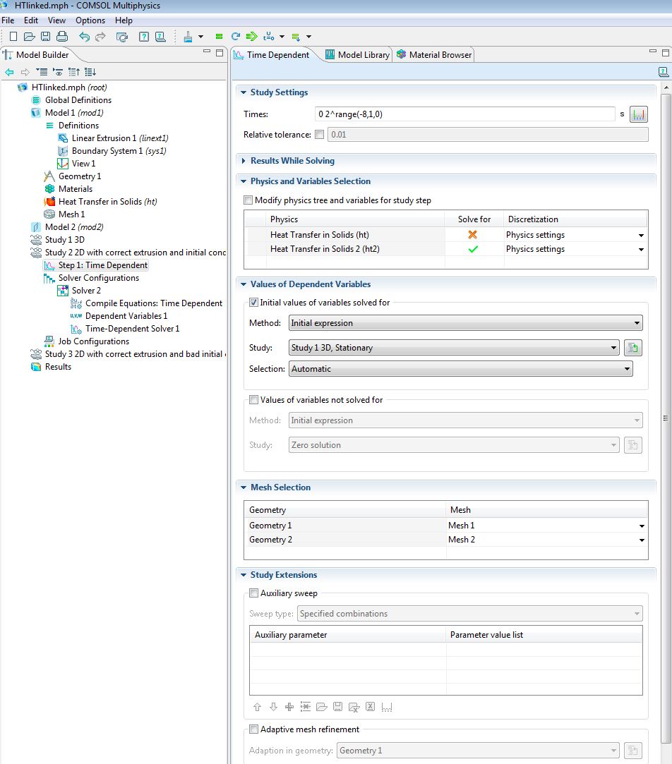

I have only 4.3a so here is a model, check carefully the linear extrusion definition on mod1, and the solver initial conditions of study 2
Hi I have only 4.3a so here is a model, check carefully the linear extrusion definition on mod1, and the solver initial conditions of study 2 -- Good luck Ivar

Thank you Ivar! But I've got the 4.3 version. Can you upload some pictures of how is the model set? Specially how to set the source with the extrusion operator and when replacing the z coordinate for the t coordinate.
Thanks again!
Thank you Ivar! But I've got the 4.3 version. Can you upload some pictures of how is the model set? Specially how to set the source with the extrusion operator and when replacing the z coordinate for the t coordinate. Thanks again!

Hi Ivar, another question. If the model 2 gemoetry is 2d, why there are points 1, 3 and 5 in the extrusion for gemoetry 2? Geometry 2 must be a flat square, and there are only 4 points.
Posted: 1 decade ago 2013/02/23 3:17 JST
in 2D you define the origine, the X direction and a Y direction, for source and destination (you fill in the 4th point if you do a 3D mapping
Hi in 2D you define the origine, the X direction and a Y direction, for source and destination (you fill in the 4th point if you do a 3D mapping -- Good luck Ivar
