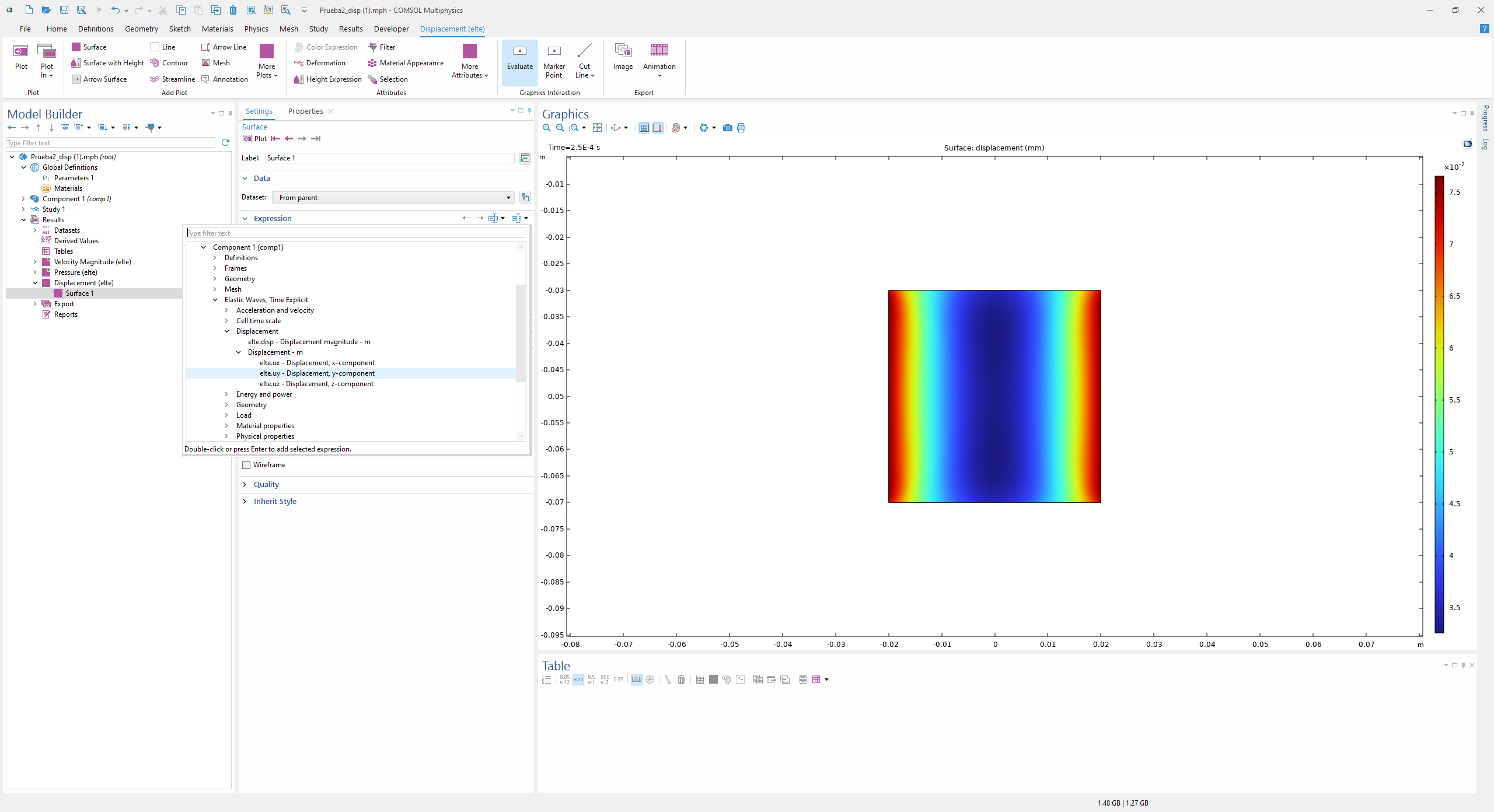

If you look through the list of available expressions available for postprocessing in your Surface plot, you'll see one called elte.uy that seems to be the one you are looking for.

I am referring to displacement. I think “elte.uy” refers to the position, or am I wrong?

It's the displacement in the y direction, see the attached file.
