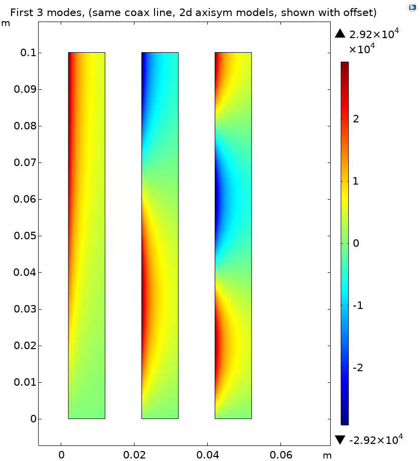

Sounds like you want to use the RF module, frequency domain, with an eigenfrequency-type study, with a short circuit (a PEC) at one end of your coax and an open circuit (lumped coaxial port with a nearly-infinite impedance) at the other. Be sure to set the solver to look in the vicinity of the resonant frequencies of interest. I just tried that and it worked fine. See the attached image, showing 3 separate solutions (leverages the "array plot" feature). Plot is of the radial component of E. (I would include the .mph file, but I have a more recent version of Comsol Multiphysics than you.)

It works. Thank you sir, it helps a lot.
