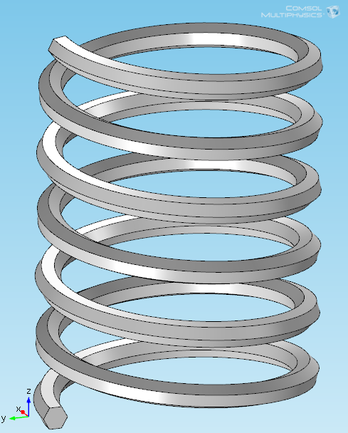

Use Parametric Curve and Sweep options to create helix of arbitrary cross-section. Example is shown in the attached file.
Sergei

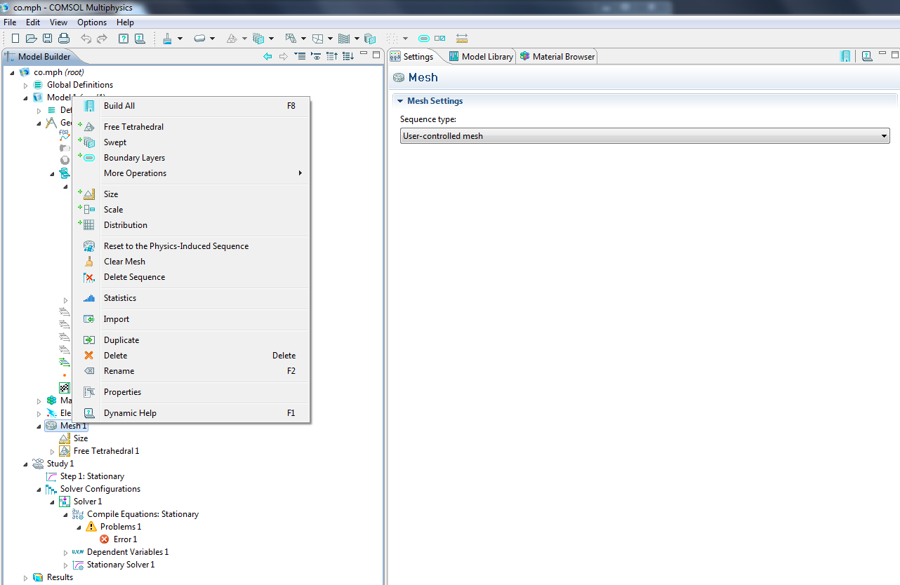

But I didn't see "dimension" sub tab on the mesh node(see attachment)... Or is it possible to use a for-loop directly in comsol?

sorry my fault it's "Distribution",
read the doc about the mesh nodes, its important to understand in which order you call them and the difference of a major node and a sub node, performing a few of the model library examples helps too, at least those (or the video) about the meshing

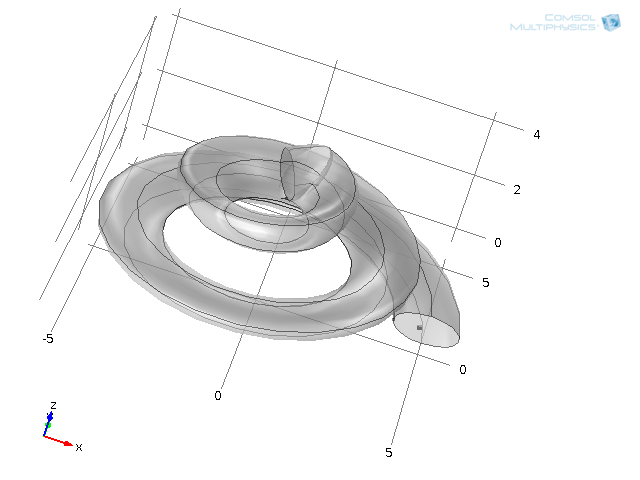

There are two parts that I need help in my model attached.
~ How to taper the cross section along the parametric curve to avoid overlap of material (in current model I increase the radius and height to avoid it which is non-realistic), supposing I know the tapering function
~Is it possible to extrude the workplane in the direction of the curve without any twist. i.e. the corss section is always perpendicular to the base plane(xy-plane). just like the attached image, I think it might be achievable. Otherwise, since I don't know the function of twist. It would be impossible to track the path of a specific point of the workplane which is actually very important for me.
It'd be very nice of you if you can offer some solution/idea. Thank you very much.
I'm not sure about tapering in COMSOL, the twist is an issue too, I haven't really managed to get it right, sometimes I wonder how much is a graphical issue and how much is real ;)

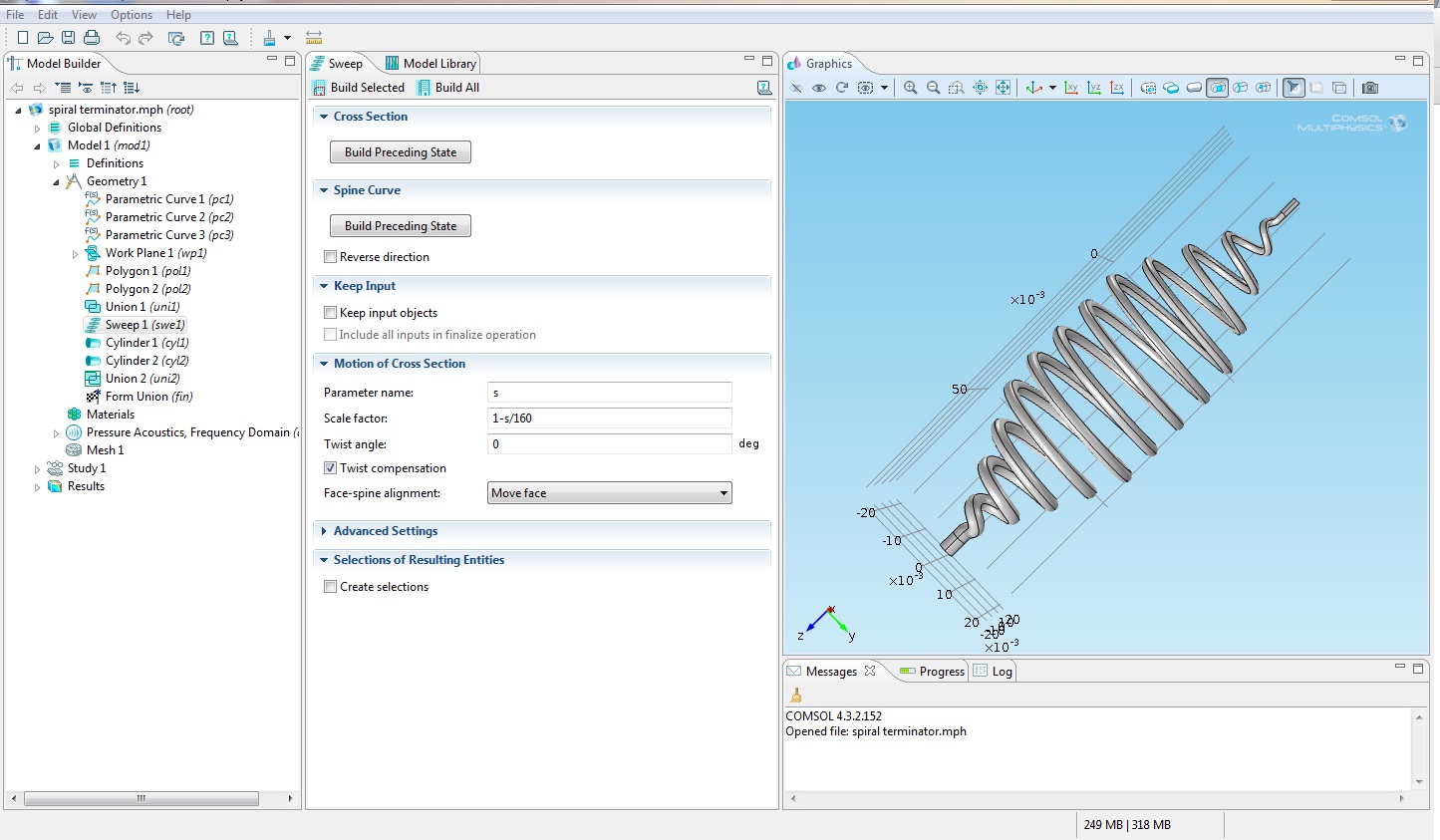

I manged to get a tapered helix by putting 1+f(s) (where f(s) is the function of s required) in the scale factor box.
Im not sure what the scale or bounds of 's' are or where you would find these

I dont know how to save as a previous version so here is a screen shot the important bit seems to be the 1 in the scale factor box.
I would still like to know what the bounds on the parameter s are.
