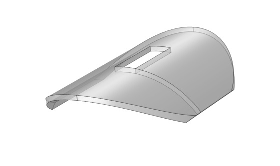

I am currently working on designing a coil in COMSOL Multiphysics and would appreciate some guidance on how to proceed. My goal is to model a coil and simulate its electromagnetic behavior, but I am unsure about the steps involved in setting up the physics correctly. my coil design is so complicated for me. i upload image of my coil for you in real i have this coil.

thanks i look to some of them before but i think my coil structure is a bit more complex than the tutorials. it's bend over and have a rectangle shape hole. i need an idea to design it or someone who can give me an insight to define me physic better.

thanks for your reply. I uploaded a 3D model of my coil name as "untittled.jpg" before. this coil putted on a pipe . i need to study the megnetic field of this type of coil. i tried to design it easier by design a HelmHoltz coil(simple circular coil) and then use "scale" in "tranforms" to shape it like an oval but i don't know how to bend my design. i thought becuase my coil has more than 750 round of wire it's better to design a 3D model of it not a actual coil it's my fist time that i use COMSOL so i come here to ask help from experts
