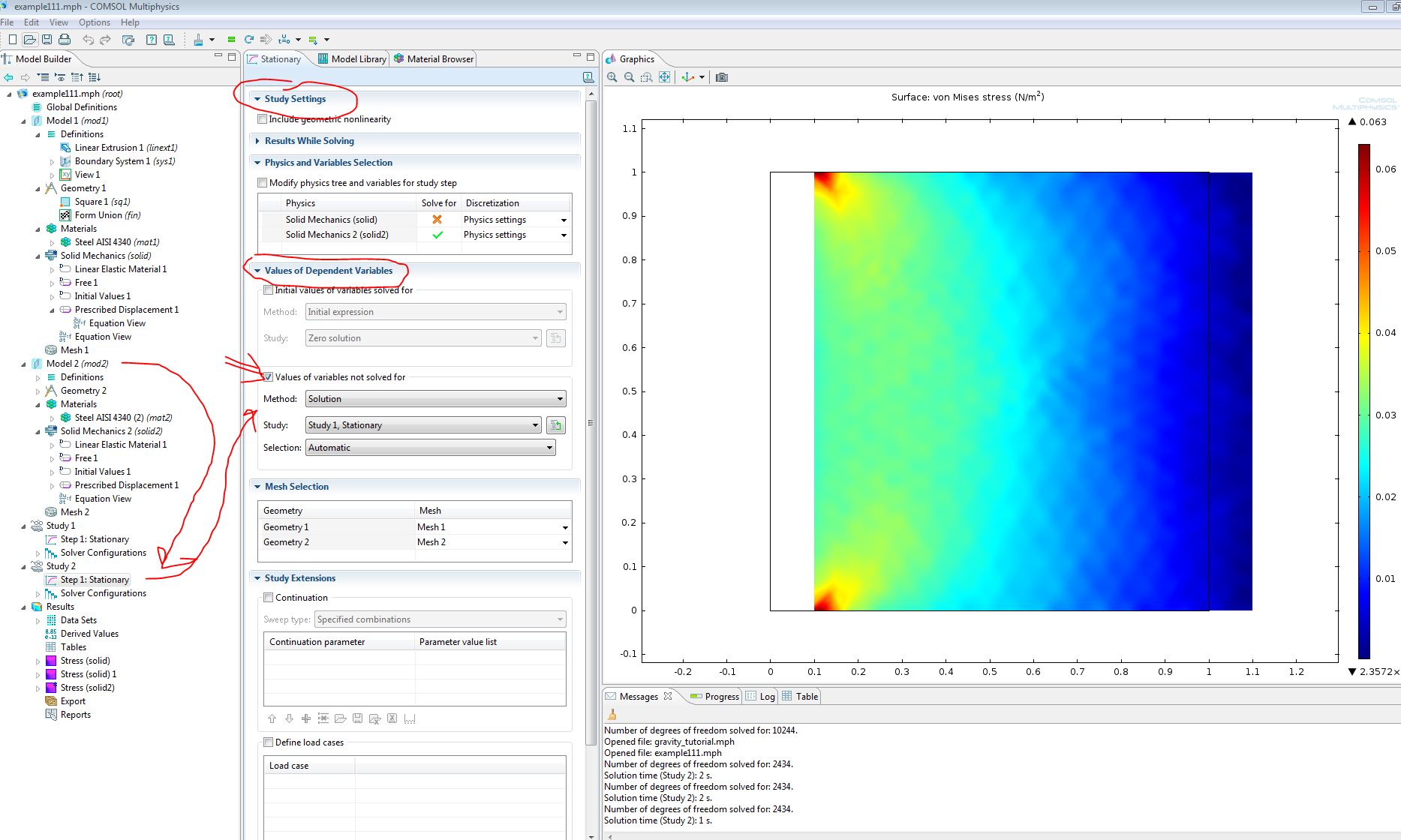

Hey,
I have a trouble with defining a prescribed displacement.
Let's say that i received displacement of the edge caused by heating of sample. But displacement of this edge is different in every point of its length.
I want to keep this displacement as prescibed displacement condition in next study. So i can't just add condition prescibed diplacement in y=a, becouse it's more like ax*bx^2.
I tried to use mod1.u as prescribed in y, but it's not working or I doing something wrong.
How can I solve this problem?
Kind Regards
Robert
