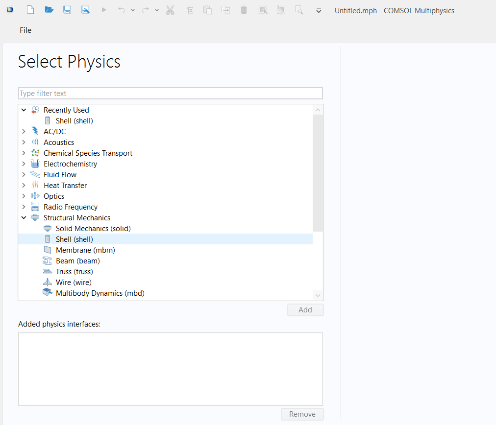

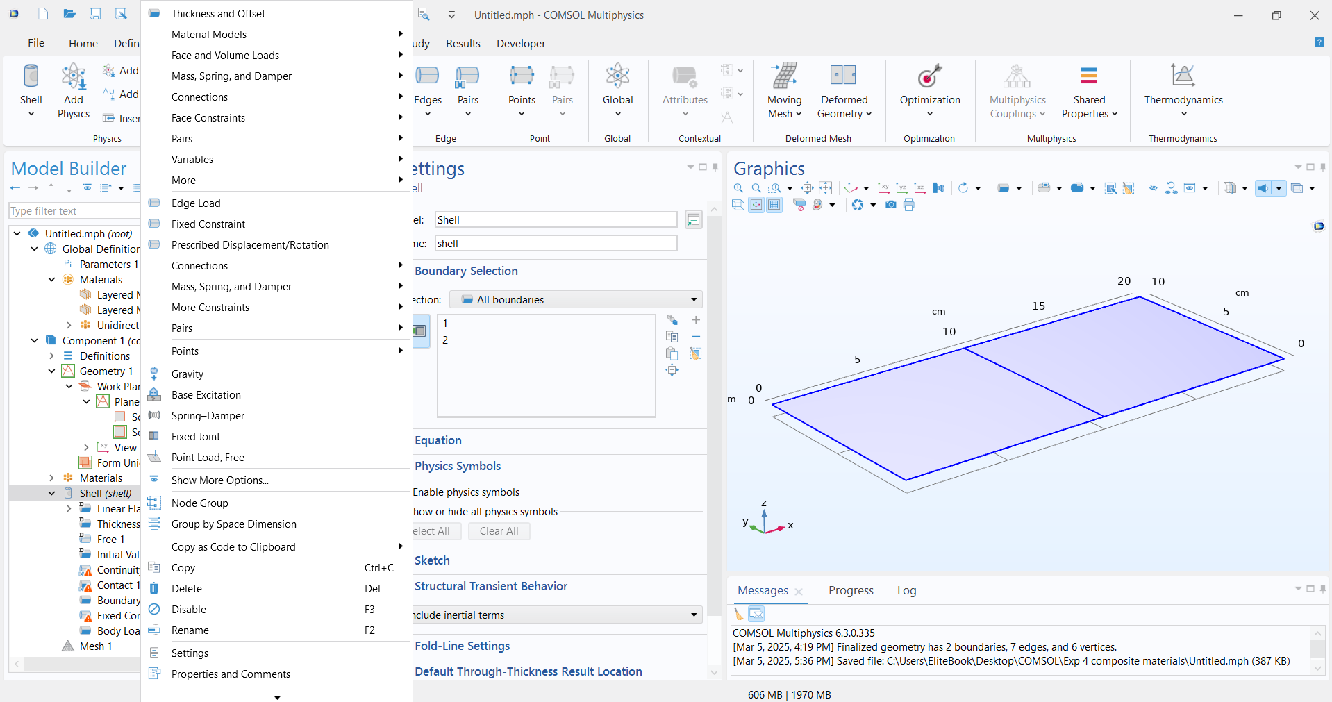

Hi Jeff,
I just checked my license and realized that it does not include this module. Is there any way to have it added? I am using Southern University Denmark’s COMSOL license.
If I manage to get this module included, it should resolve both of my issues:
The Layered Shell option under the Structural Mechanics tab, which is currently not visible.
The option to join two layers using the continuity boundary, which is also missing from my license.
I’d appreciate any guidance you can provide on this.
Ali
