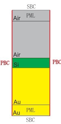

I am also facing the same problem. I am using 2D slab waveguide with core 3.47 refractive index and cladding region is of 1.45 value. Comsol simulation shows smaller effective index value than what I have analytically calculated. I don't know why I am getting this smaller effective index value.

                                                    Have you tried by increasing the resolution of your mesh?

Thanks for your reply. Yes, I have tried even smaller mesh size but I am not getting the expected result. I have tried different dimensions of my waveguide, different mesh sizes but unfortunately not getting the  same value as I have obtained by analytical analysis.

I think problem is that you have search for mode around value is lower than your lowest refractive index.
The value of search for mode around should be between the higher refractive index and lower refractive index.
Study>>>Mode analysis>>>Study setting>>>Search for mode around>>>>insert value 3.47.
Also, check mode analysis frequency>>>c_const/1550[nm] or direct frequency (Your operating Frequency or wavelength).
May it works.

Yes I have entered refractive index value to be find as 3.47 and search for mode around option. Now I am concluded after all the experiments that when I am taking small dimensional waveguide it is showing effective index value near to 3.3 but when I am increasing my waveguide dimension its effective index starts decreasing. So may be our device dimension also play an important role in finding effective index value.
