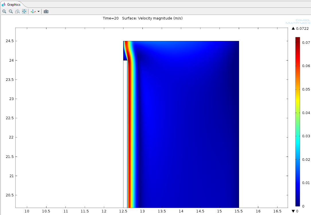

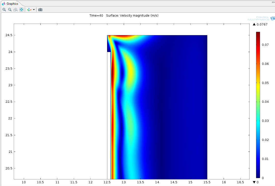

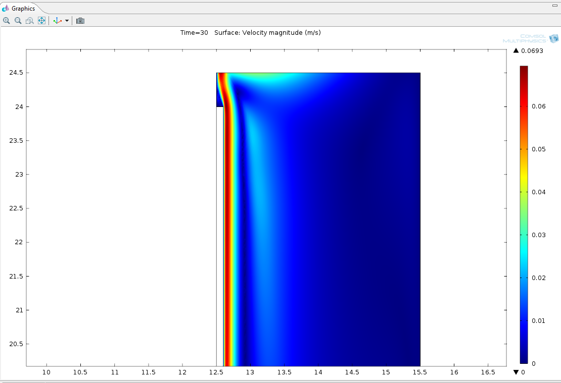

I am wondering how I can improve convergence in my natural convection model. It is a simple model; an isothermal aluminum plate in water.
The model starts out fine but as the run continues (transient model), the plume begins to lose stability causing the problem to reduce its time stepping. I have tried re-meshing as much as my PC can handle (3 mil elements).
I am wondering what else I can do to solve this problem. Should I change tolerances, crosswind or streamline parameters. I am running out of ideas. Any help would be greatly appreciated ( as I have been stuck on this problem for several days now). I have attached the model (with no mesh or solution). Typically, the model solves the first 20-30 seconds, then the solution becomes very strange and results become unreasonable.
8 Replies Last Post 2013/04/26 14:50 JST
Posted: 1 decade ago 2013/02/25 7:31 JST
I additionally tried using segregated solvers (2 segregated solvers 1 for pressure and velocity and 1 for temperature). I have read this should help solve highly nonlinear problems. But again after about 30 seconds into the transient solutions, the solution fails.
Edited: I added some of the solutions so readers do not have to open and run the model. Solutions are plotted for times 20, 30 and 40 seconds into the simulation.
I additionally tried using segregated solvers (2 segregated solvers 1 for pressure and velocity and 1 for temperature). I have read this should help solve highly nonlinear problems. But again after about 30 seconds into the transient solutions, the solution fails. Edited: I added some of the solutions so readers do not have to open and run the model. Solutions are plotted for times 20, 30 and 40 seconds into the simulation.
