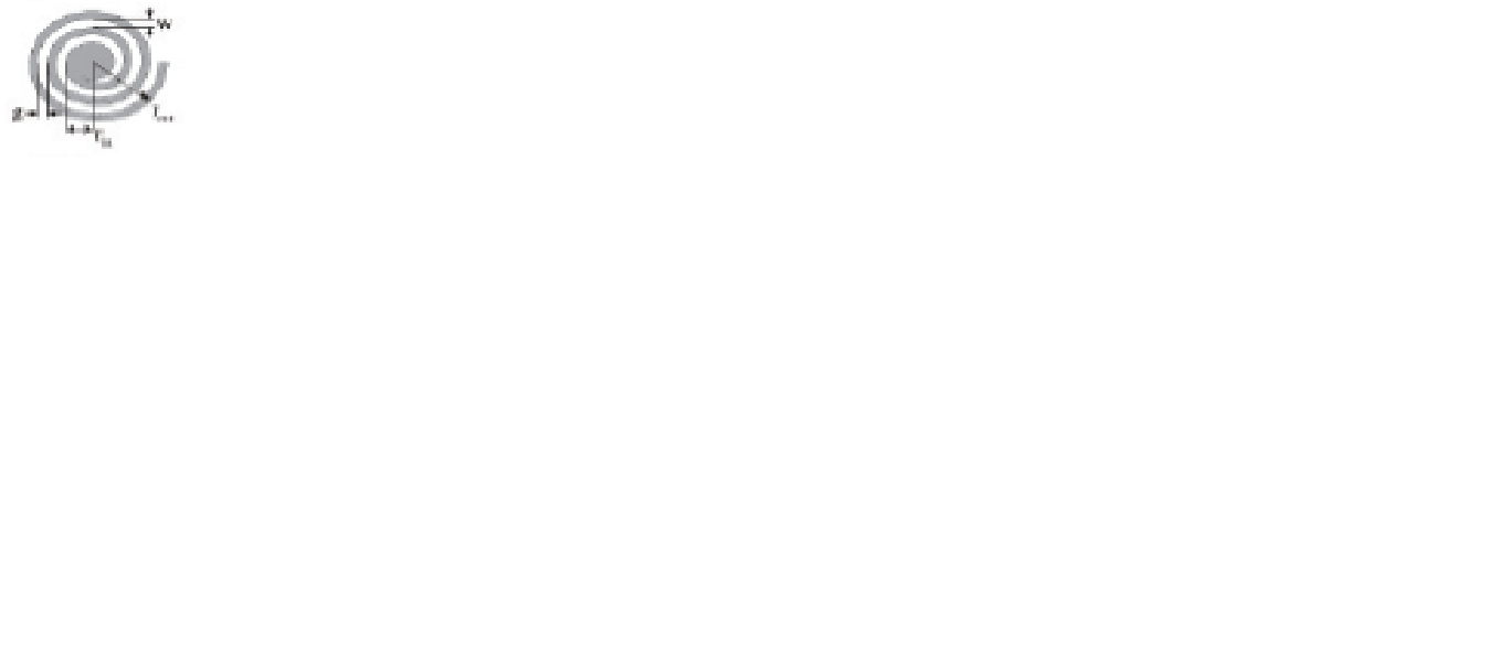

Ok, Thank you for atleast coming forward to help me. Iam trying to design a Split Ring Resonator(a spiral ) for my project. Iam struggling with it, as iam very new to comsol.
can you give me an idea how i can start with this and proceed. I attaching a image of the spiral. I read some where that i can create a spiral usind the parametric funcion.
