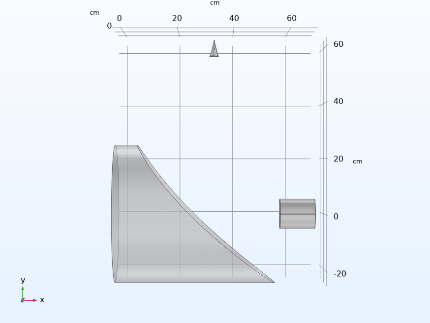

Here is my problem: I am trying to focus microwaves launched from an open-ended circular waveguide at 2.45 GHz to the inside of a small diverging nozzle (essentially a cone with metal walls). I am working inside of a vacuum chamber, so I am limited in space, therefore I am trying to implement a custom off-axis parabolic (OAP) mirror, assuming a mostly collimated incident beam which will be reflected and focused to a point, at which location I'd place the nozzle.
In the image attached, I have the OAP, section of circular waveguide, and the conical nozzle modeled in the domain. I would like to put this setup into a 2D simulation, but I am having a hard time knowing how to correctly define the port as there is no circular port option. I don't have the strongest EM background, but I believe I would need the e-field distribution for TE11 mode with a circular waveguide.

Your overall geometry is not axisymmetric and it is not well suited to an ordinary 2D model either. However, you could use a 3D RF model with a symmetry plane. Alternatively, if you wish to pursue a simpler 2D axi-symmetric model of the horn alone, you can represent the azimuthal dependence of the TE11 mode analytically. This hybrid approach is illustrated in examples provided by Comsol in the Application Library. See https://www.comsol.com/model/fast-numerical-modeling-of-a-conical-horn-lens-antenna-18695 and also https://www.comsol.com/model/corrugated-circular-horn-antenna-15677 .

I have it set up in 3D, I was just hoping for computational simplicity to be able to do this in 2D as well; what is the reason it's not well suited to a 2D model? I will take a look at that example.. However, I suppose I should have clarified in my post that the conical structure will in fact be a nozzle for an electric propulsion thruster, but does in a way function like a receiving horn antenna. The crux of my problem lies in the fact that the target area is small relative to the wavelength, and unfortunately we do not have power sources at higher frequencies or the capability to increase the nozzle size, therefore I am trying to come up with a creative solution.

For an ordinary 2D model (Cartesian, in x,y coordinates) to be representative of 3D reality, there must be no important dependences on directions perpendicular to the plane (e.g., dependence upon z). That requirement clearly isn't satisfied here. Simiarly, in a 2D axisymmetric model, there should be no important dependence on the azimuthal direction (phi), EXCEPT that in the rather-clever example models that I cited, one can address this problem by means of an analytic extension that represents the phi dependence of the mode(s), while using Comsol's finite elements-based computations to solve for only rho and z dependences. Now, if you were to replace your "offset" reflector by an axisymmetric reflector, you could in principle make use of the same trick yourself, since once again, the azimuthal dependence could be handled analytically. This would greatly reduce the computational size of your problem compared to a 3D treatment, so you might want to consider doing that. (If so, study the examples carefully and make sure you understand exactly how this trick was implemented.)
