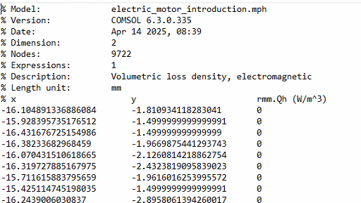

Am I correct in assuming that this value represents an average over all computed time steps? When I look at the dataset from the "Time to Frequency Losses" study and export the rmm.Qh value, I only see X, Y, rmm.Qh (see attachment). Which leads me to conclude that rmm.Qh is only a one-dimensional vector. This leads me to believe that the iron losses calculated in this study are not time-dependent—is that correct?

Steinmetz and many other analytical loss models as well as specific loss data supplied by magnetic steel manufacturers, specify iron loss as a function of flux density and frequency. To this end the Time to Frequency Losses Study performs a forward FFT from the time domain to the frequency domain to compute the losses. Your observation is correct, the computed rmm.Qh is the space distributed loss, time-averaged over the period specified as input to the Time to Frequency Losses Study. This means that iron losses cannot be observed as a function of time when computed this way. It is however possible to inspect the iron losses for each of the harmonics.
A pre-requisite to the Time to Frequency Losses Study is a steady-state time-dependent solution. That is when all oscillations are periodically repeating and any transients has vanished, and which is perhaps what you mean by "settling process"? The iron losses are computed as a result of the time-dependent solution, and is not suitable as a probe for steady-state operation. For this, inspection of losses in materials with non-zero conductivity e.g. magnets in your model, is a good indicator. Here the instantaneous loss is computed as time advances. With this you should be able to determine when time-dependent simulation has stabilized and hence what portion of the solution can be used as input to the Time to Frequency Losses Study.
