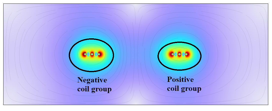

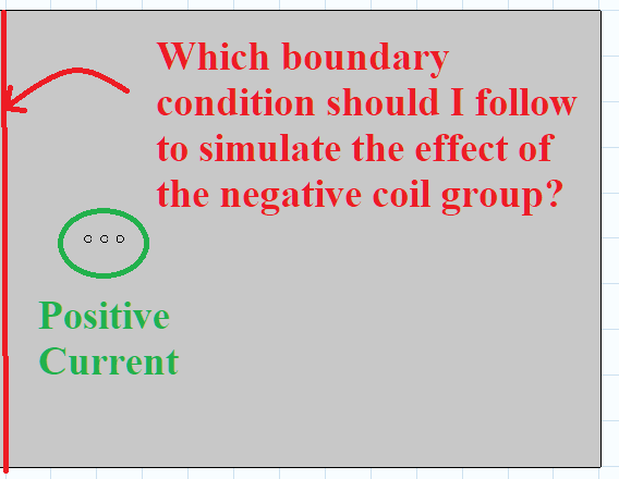

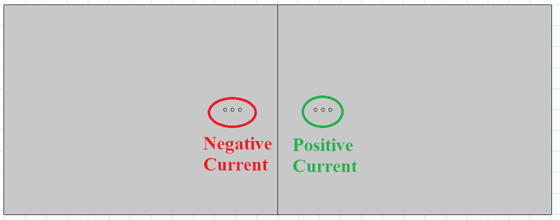

Next, I want to speed up my simulation by performing half-symmetry conditions in my model. However, I am unable to model the return path.
Which boundary condition can I use for 2D simulation (not 2D Axi-symmetric) in the Magnetic field interface? I have tried all different boundary conditions like PMC, Symmetry plane, but I still have not found any correct solution. i.e. inductance value is not converging.
Please see the attached PNG file for more clarification.
Thanks a lot, Magnus Olsson, for your valuable reply. The **transmission lines concept** is really useful in my simulation, where I modelled the return current path for the conductor. Next, I want to speed up my simulation by performing half-symmetry conditions in my model. However, I am unable to model the return path. Which boundary condition can I use for 2D simulation (not 2D Axi-symmetric) in the Magnetic field interface? I have tried all different boundary conditions like PMC, Symmetry plane, but I still have not found any correct solution. i.e. inductance value is not converging. Please see the attached PNG file for more clarification.

You should not choose boundary conditions based on wild guesses or simply seeking/hoping to find a choice that allows your program to execute to completion. Rather, your boundary conditions should always (at least reasonably) represent the actual/relevant physics of your problem. With that in mind, consider the right-hand rule. If you line up your right-hand thumb with the current direction in a long straight wire, the magnetic fields due to the current in that wire will wrap around it in the direction of your fingers. If you now do this with each of two parallel wires, carrying equal and oppositely-directed currents, then you can see that on the symmetry plane between them, the vector fields must be purely tangential (i.e., there will be no normal component of H). And that corresponds to the "magnetic insulation" boundary condition in Comsol Multiphysics.
You should *not* choose boundary conditions based on wild guesses or simply seeking/hoping to find a choice that allows your program to execute to completion. Rather, your boundary conditions should always (at least reasonably) represent the actual/relevant physics of your problem. With that in mind, consider the right-hand rule. If you line up your right-hand thumb with the current direction in a long straight wire, the magnetic fields due to the current in that wire will wrap around it in the direction of your fingers. If you now do this with each of two parallel wires, carrying equal and oppositely-directed currents, then you can see that on the symmetry plane between them, the vector fields must be purely tangential (i.e., there will be no normal component of H). And that corresponds to the "magnetic insulation" boundary condition in Comsol Multiphysics.

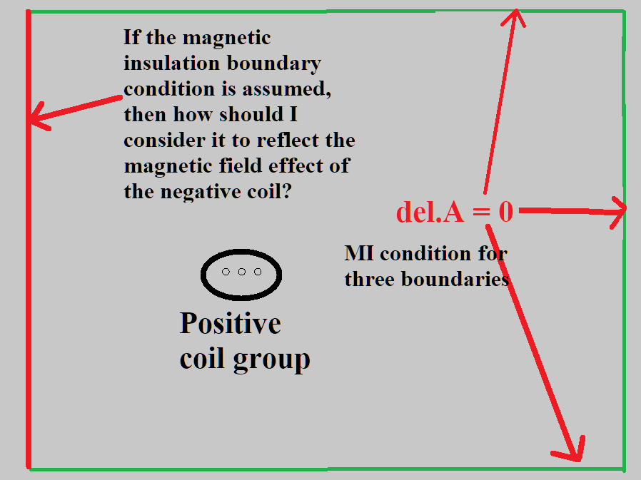

Hello Robert Koslover, thank your for your reply. I am trying to implement the simulation as per your valuable inputs. however, I am having the following doubts regarding the simulation results:
  1. I am already using magnetic insulation boundary condition with (del.A = 0) in three sides Now, how to incorporate the fourth side (See the figure attached), to consider the magnetic field of negative coil group in the simulation.
I know that (del.A = 0) condition will keep all the flux inside the solution domain. Now, how to consider boundary condition for fourth side.
Hello Robert Koslover, thank your for your reply. I am trying to implement the simulation as per your valuable inputs. however, I am having the following doubts regarding the simulation results: 1. I am already using magnetic insulation boundary condition with (del.A = 0) in three sides Now, how to incorporate the fourth side (See the figure attached), to consider the magnetic field of negative coil group in the simulation. I know that (del.A = 0) condition will keep all the flux inside the solution domain. Now, how to consider boundary condition for fourth side.
Posted: 1 year ago 2025/04/23 13:02 GMT-4
There is a left-right symmetry to the problem. If you compute the fields on one side, then now you know everything about both sides, because the missing side is simply the mirror image of the side in which you did the computations.
FYI, setting a magnetic insulation boundary condition is not the same as setting divergence of A = 0. Rather, magnetic insulation corresponds to setting to zero the component of the magnetic field (H) that is normal to the boundary. This becomes n cross H = 0 at the boundary, where n is the normal vector to the boundary.
There is a left-right symmetry to the problem. If you compute the fields on one side, then now you know everything about both sides, because the missing side is simply the mirror image of the side in which you did the computations. FYI, setting a *magnetic insulation* boundary condition is not the same as setting divergence of A = 0. Rather, magnetic insulation corresponds to setting to zero the component of the magnetic field (H) that is normal to the boundary. This becomes n cross H = 0 at the boundary, where n is the normal vector to the boundary.
