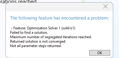

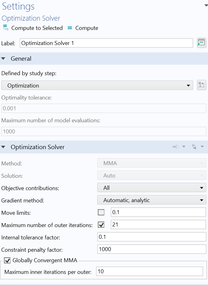

Hi Everyone, I am working on a Topology Optimization setup of model (that consists of two materials) that undergoes Induction Heating(Physics involved: electromagnetic heating) in two step study ( Step1: Coil Geometry analysis, Step2: Frequency-Transient Solver, the optimization is applied for step 2). I have setup the settings for the required density model for topology optimization as following: theta_min: 0.01 theta_initial: 0.5
Control Variable Constraints: 0.9>=theta_average>=0.5 The optimization(MMA solver) starts properly at first iteration, but after that depending on the initial value given, after some iterations, I start getting this "Warning: Forward solution failed, requesting reduced step." This persists continuously and eventually I have to cancel the compute.

If the behavior is deterministic, you can terminate the optimization solver on iterations, so that it stops for the controls that cause the problem.
You can then initialize a another study without optimization based on those "bad" controls and investigate the issue in a more time efficient manner. Alternatively, it might be possible to stop the computation by clicking the stop button next to the optimization solver on the progress tab (and waiting).

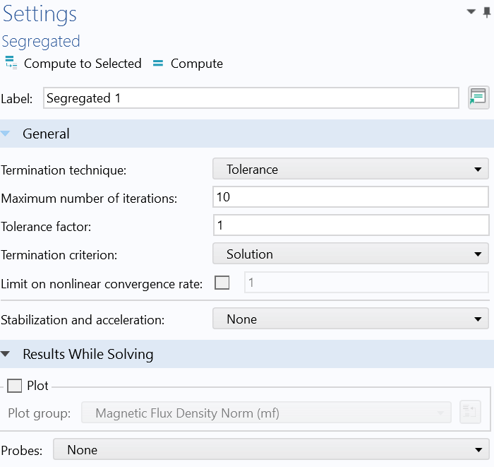

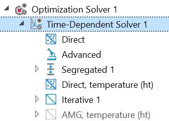

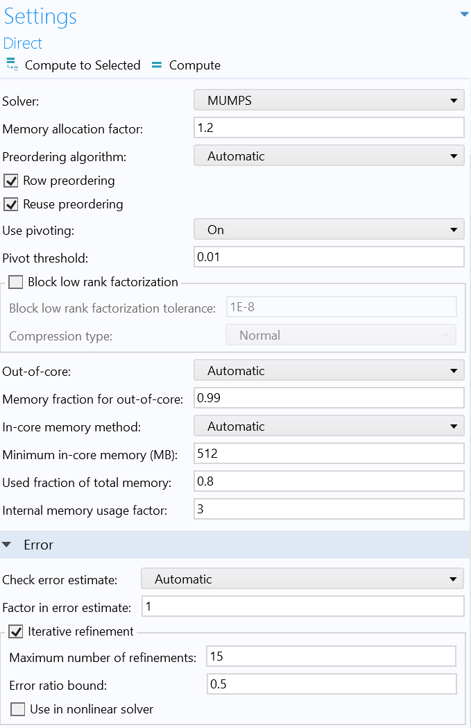

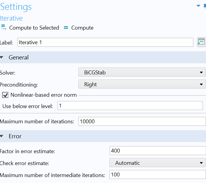

Hi Kristian, Thank you for your reply.

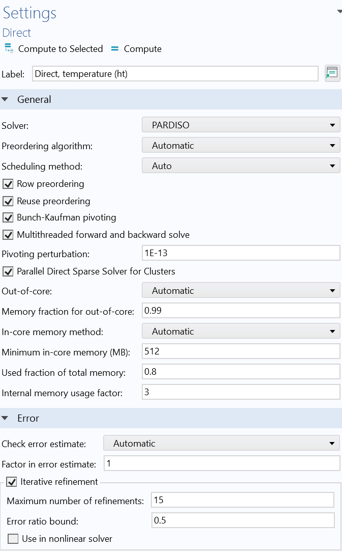

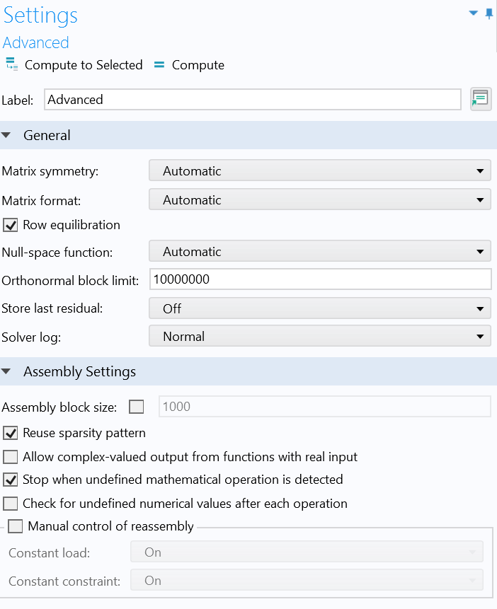

I believe I am using the linear solver, and think the forward solution warning appears during the "advanced" solver step as once the segregated solver starts, there will be a objective function result but if the advanced solver step has problem moving forward, I believe thats when the warning appears based on my observations. Right now, I am trying with stricter time steps(inital time step: 0.001) and manual absolute tolerance(0.001) in time solver and am attaching the screenshots of solver and solver config settings, so please go through them and let me know any recommended changes or things causing the issue(most of them are default settings).

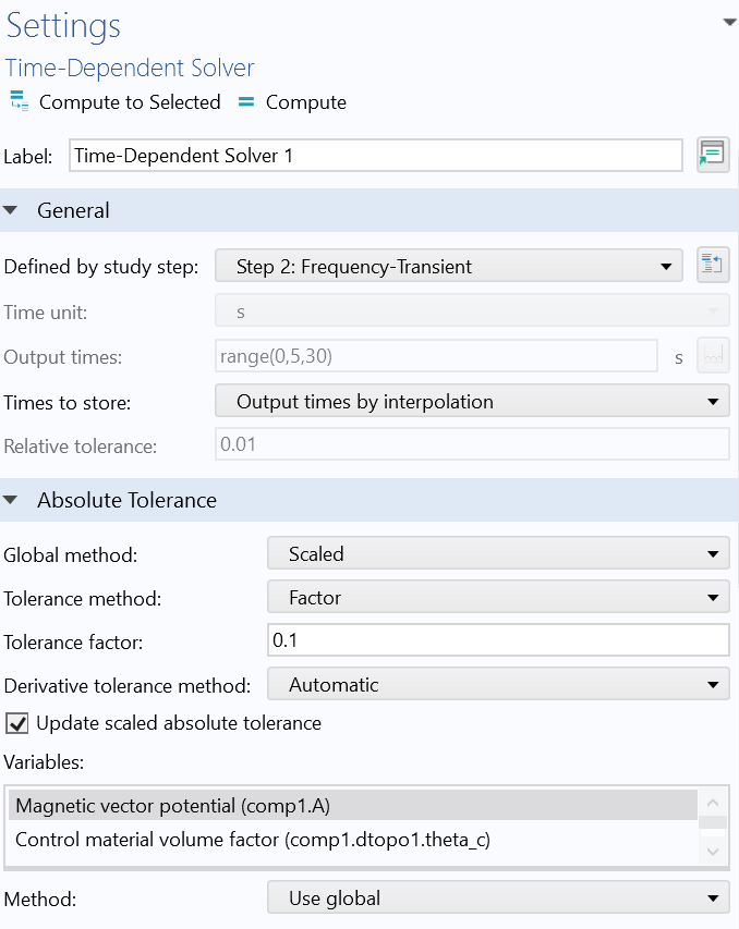

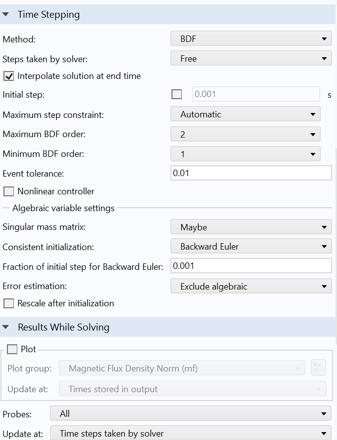

Posted: 9 months ago 2025/04/25 6:35 GMT-4
Hi Ashok

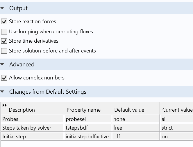

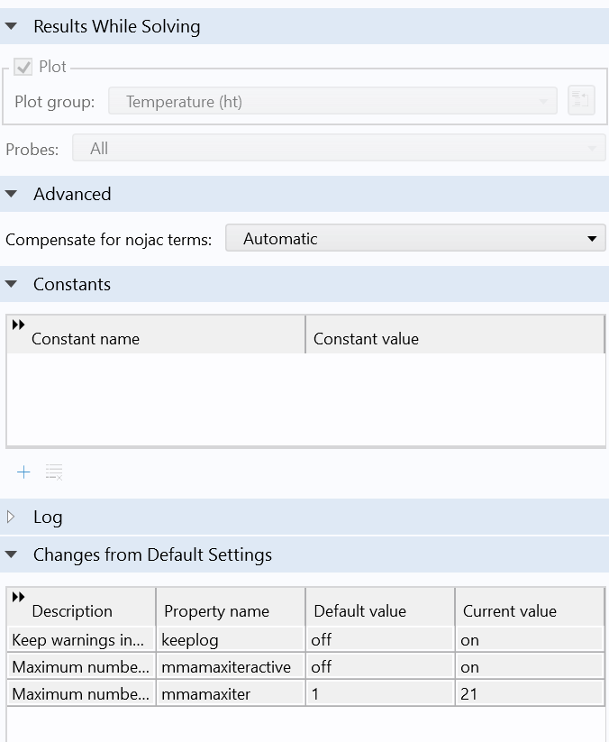

My apologies: The Frequency-Transient study step obviously generates a time dependent solver.
Lowering the order of the time integration can also improve robustness. If you are not using the v6.3, this can also be the reason, because accuracy, robustness, and performance was improved significantly in the latest release due the introduction of a new sensitivity computation algorithm (time discrete as opposed to the old time continuous adjoint).
