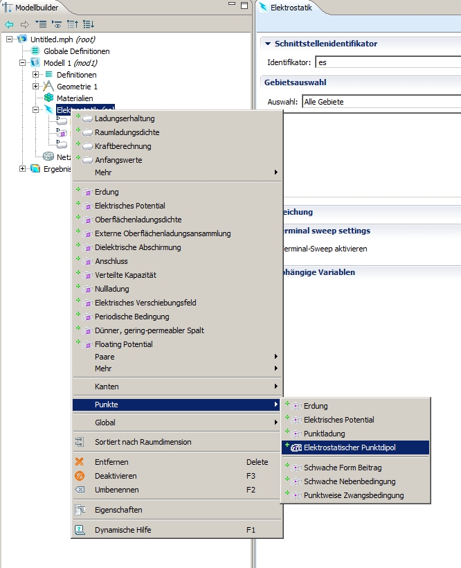

in the magnetic fields interface you can find the electrical dipole in the model builder according to the figure i attached.
The singular matrix is probably due to the fact that you tried solving the system without an exciation.
Bye
Eric
Hello, in the magnetic fields interface you can find the electrical dipole in the model builder according to the figure i attached. The singular matrix is probably due to the fact that you tried solving the system without an exciation. Bye Eric
