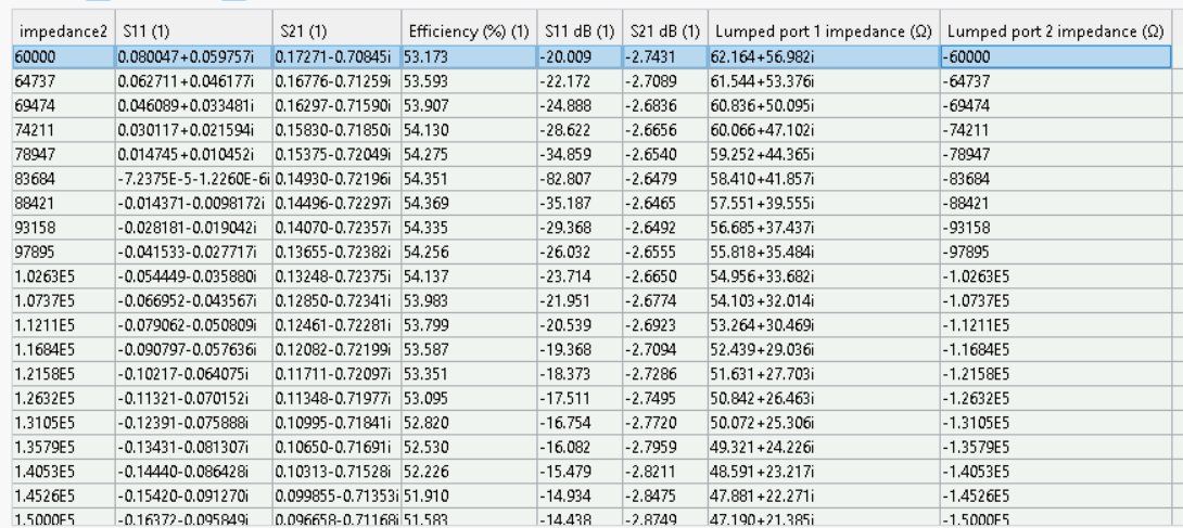

When I change the impedance of one lumped port, it changes the impedance of the other, so I'm not sure how I can know what one should be without knowing what the other should be, I've attached the results of sweeping through the impedance of one of the lumped ports.
Also, I wanted to ask what the physical meaning of giving an impedance to the lumped port is? Is this adding an impedance in series to the rest of my coil? I am quite confused.
Thanks again
When I change the impedance of one lumped port, it changes the impedance of the other, so I'm not sure how I can know what one should be without knowing what the other should be, I've attached the results of sweeping through the impedance of one of the lumped ports. Also, I wanted to ask what the physical meaning of giving an impedance to the lumped port is? Is this adding an impedance in series to the rest of my coil? I am quite confused. Thanks again
Posted: 1 year ago 2025/05/27 14:04 GMT-5
Sure, the two coils interact and will mutually influence their impedance. Regarding the meaning of impedance I recommend some textbook study. Get yourself a book with a focus on electrodynamics and RF networks. This stuff is fundamental to what your model is about and it is a little beyond the scope of this forum.

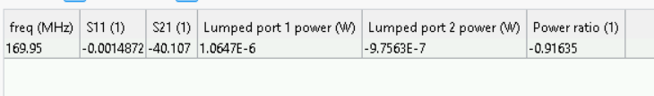

Hi, I have tried something else now, and I am getting conflicting results.
I instead printed out the powers of the two lumped ports, and take the ratio of those to get the power transfer efficiency. I am getting a negative power on the second lumped port. Is that because it is receiving power as opposed to outputting it?
Also my S21 value is ~-40 dB, and still indicates that very little of the signal from port 1 is reaching port 2. This conflicts with the powers that I am seeing, which says ~90% of the power is being transferred. Am I mistaken in my interpretation of one of these values?
I have attached an updated model, with an image of the numbers I got from them.
Any input or advice is greatly appreciated Thanks
