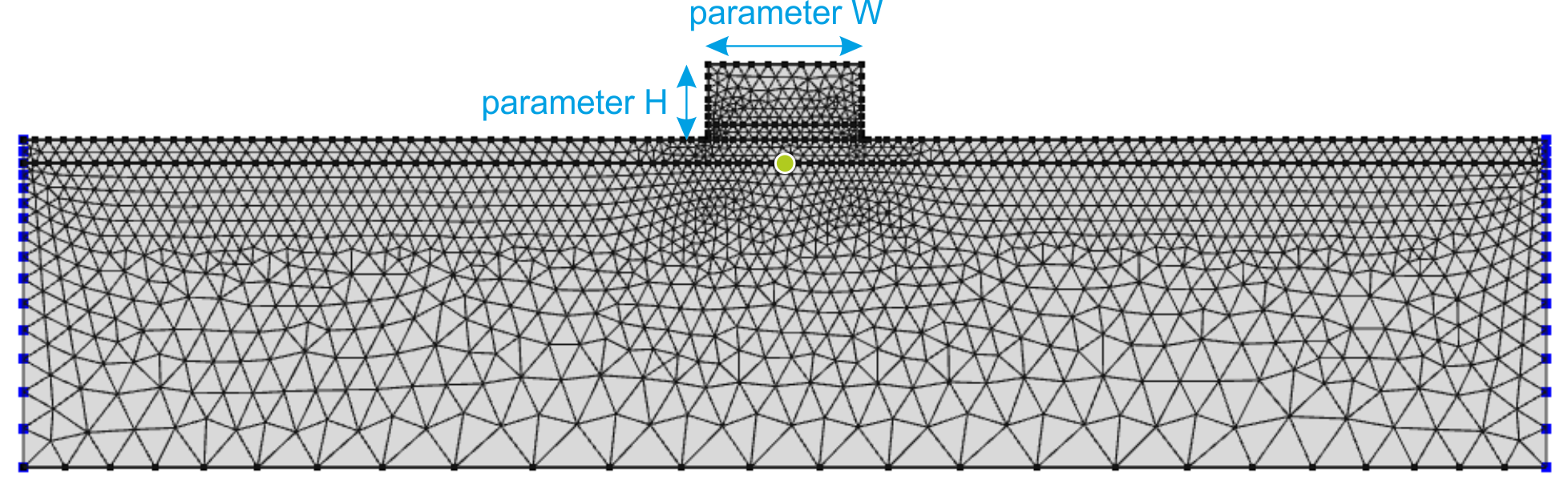

Well, I'm interested in a model as attached. I'm using the Structural Mechanics Module in order to calculate a deformation at low temperature caused by different thermal expansion coefficients. Therefore I have two parameters to play with: the width of the top metallization and its height. But, I'm just interested in stress calculations (solid.sy, solid.sxy) relating to the centered point X shown in the attached figure as well (green). I set the point already in the model to make it selectable after the calculations.
My problem is, that the calculation will calculate everything and the calculation time will increase extremely (1s for one pair of parameters at the beginning and up to more than one minute at the end) due to the fact, that the whole solution for every pair of parameters and for the whole mesh is buffered in the memory. Concerning that matter the server will crash in most cases at 80 or 90 % of calculation.

Is it possible to restrict the scale of calculation, so that only the mentioned values (solid.sy, solid.sxy) at the point X will be (calculated and) buffered?
