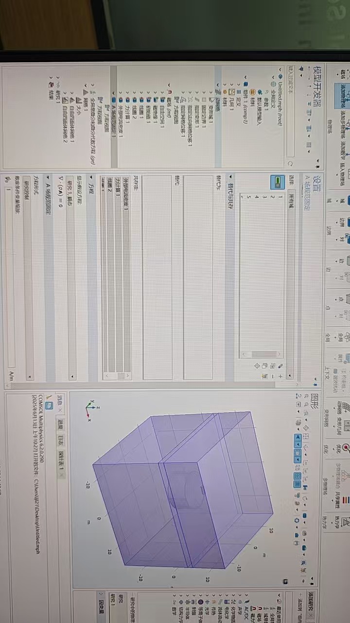

Dear colleagues,
I would like to seek your advice on a moving mesh simulation issue.
Current Model: I am simulating "the motion of a current-carrying conductor rod under the influence of a coil's magnetic field."
Physics Interfaces Used: Moving Mesh Magnetic Fields (AC/DC Module) Global ODEs and DAEs (for equation-based modeling)
Implementation Details: In the Magnetic Fields interface, I added a Force Calculation condition to compute the electromagnetic (Lorentz) force. The calculated force is passed to a global differential equation: F=ma=mxtt The displacement is then fed into the Moving Mesh interface to update the conductor rod's position. Since the electromagnetic force changes as the rod moves, I use Transient Analysis in the study step.
Issue: Despite multiple adjustments, the simulation consistently fails with the error: "A fatal error occurred during assembly or calculation."
Request: Has anyone encountered similar issues or have suggestions for troubleshooting? Any insights on: Correct coupling between Magnetic Fields, ODE, and Moving Mesh? Solver settings for such coupled electromechanical problems? Common pitfalls in force-driven moving mesh simulations? Thank you in advance for your expertise! Best regards,
Liu

If you can, please share your .mph file.
Hi, If you can, please share your .mph file.
