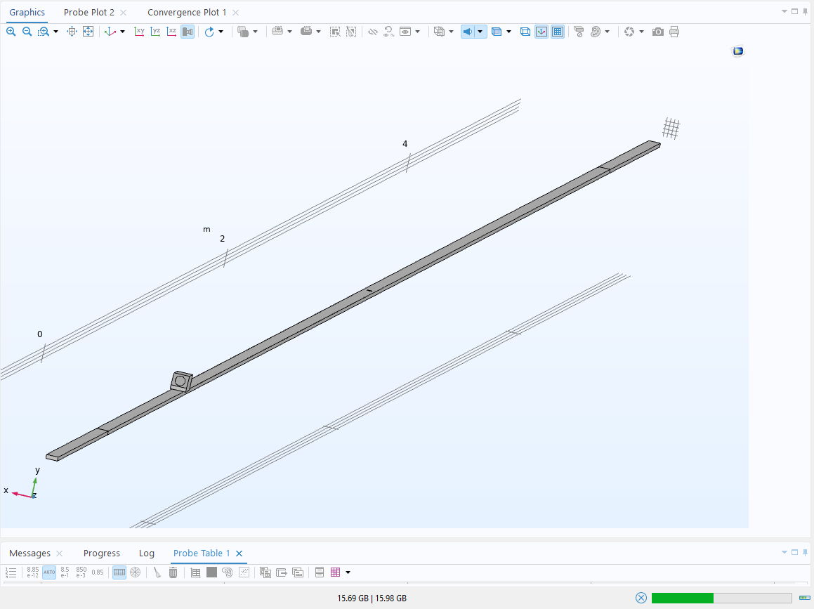

I’m currently running a Lamb wave simulation in a plate using COMSOL Multiphysics. The original model length was 50 cm, and it used to take roughly 1 day to complete on a system with 32 GB RAM. I recently increased the model size to 550 cm and upgraded my system to 96 GB RAM, expecting improved performance.

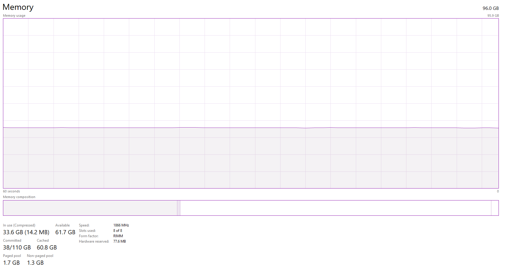

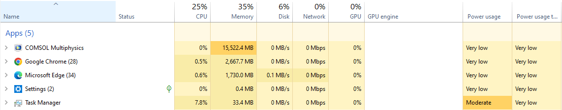

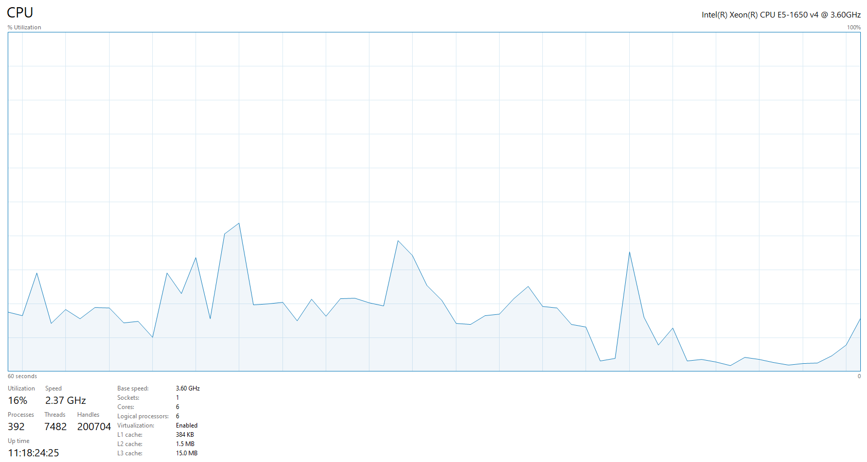

However, I’m seeing very slow simulation speeds. The simulation is around 45% complete after more than 10 days, and it seems stuck for the last 4 days. Monitoring system performance via the Windows Task Manager, I noticed:
  • Memory usage is high, but
  • CPU usage is almost idle, which is confusing.
It looks like COMSOL is not utilizing the CPU at all, or only minimally, which might explain the delay. Could anyone guide me on:
