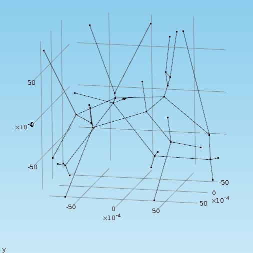

I need to have a simulation of electrical potential in 1D beam elements in a structure. I want to give potential to one point of the model and ground to another point and observe the current flow inside the beam. in fact I need to calculate the whole electrical resistance inthe structure.
when I use Electrical Current in AC/DC module, it tells me that it is not applicable to select a point as a "point electric potential" or "point ground".
I have attached a picture of a sample structure.
How can I do this. should I use another module?
Thanks in advance
Ehsan

actually the structure will go undet tension and I want to see the electrical resistance change during the tensile loading. thats the reason to do it in comsol.
two side of the structure are connected to a power supply and by loading the current changes in each section.
the structure is not made of wires, it is a cellular material so based on their diameter they have a specific resistance.

I have touse 1D element(so just lines) because the model is huge and it will be very expensive to model it in 3D.

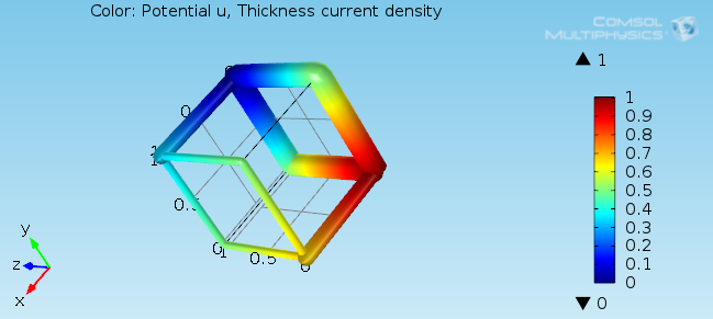

as there is hardly anything that can't be done in COMSOL there is also a solution for edge currents in 3D.
You can very easily use the coefficient form on edges to model that. The attached model shows a wire cube
(the kind that electrical engineering students at my study time needed to solder in their base practicals).
Two corners are connected to ground and a potential. The picture shows the potential and the current density.
For symmetry reasons one branch is completely current free.
If you want to wrap that equation into a physics interface you can also do that using the physics interface builder.
Sven
