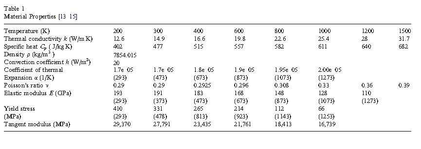

i have analysed thermal stress by passing the laser beam on rectangular plate (through structural mechanics module).i used stainless steel temp dependent material properties to my simulation. i used elasto plastic properties yield and tangent modulus. i have attached the properties also.i satisfied with results of deformation of plate and temperature profile. but my major problem is von mises stress exceed the ultimate stress level.

Thanks for your reply.i used temperature dependent properties by using interpolation function.but i am getting 700mpa von mises stress .but stainless steel ultimate tensile strength is 515 mpa.
