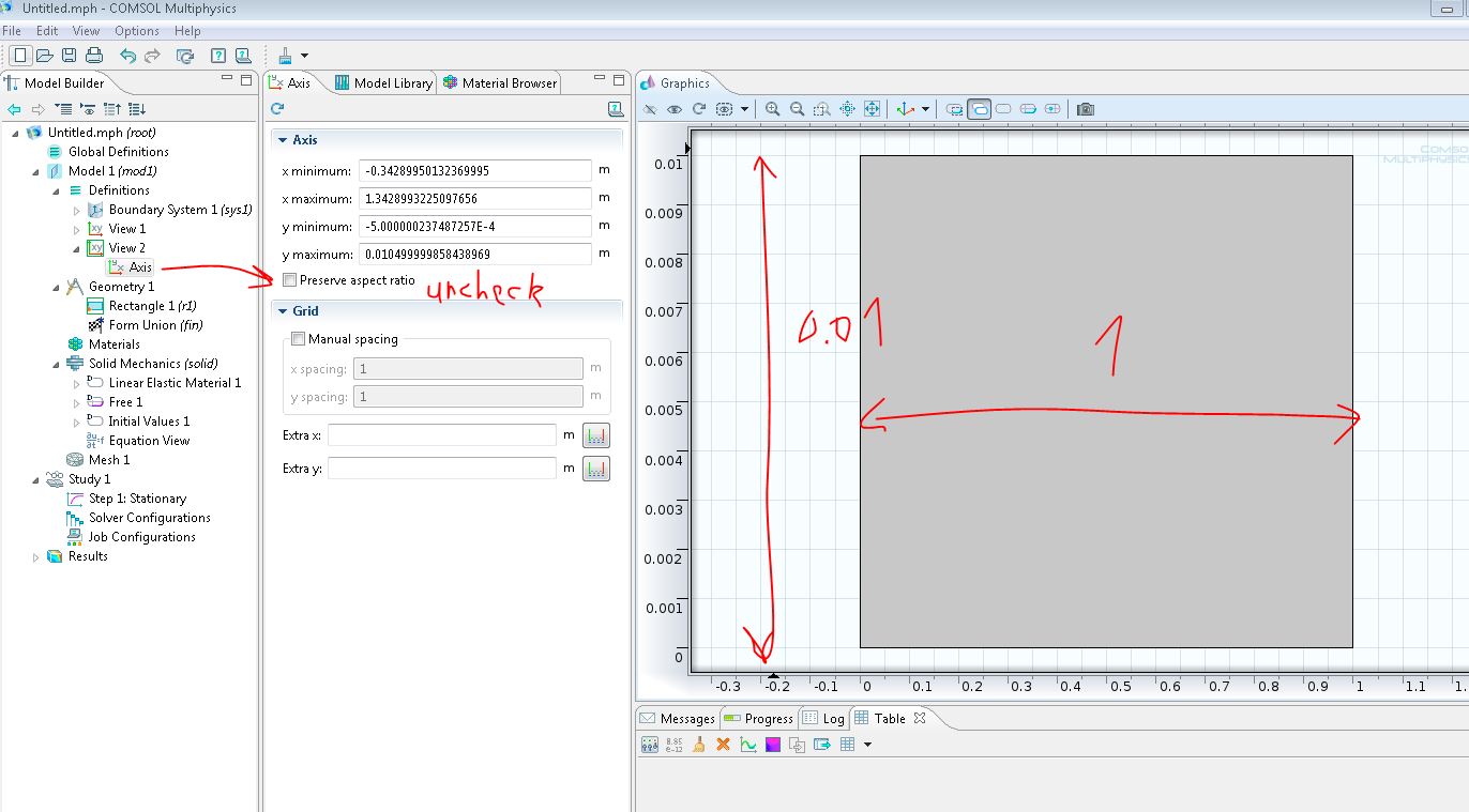

have you tried to turn off the "respect axis scaling" in the View subnode "axis". this is often handy when working with mems type structures.
Also what I do, I add a few views, and in the different I add hide entities or objects (for geometries) then its easier to work on the different parts, the scale is a bit odd, and its not very usefull to chekc meshings like that, therefore I lieve the first default view in "default" settings, and you just click on the view and its there (there are somethig to define user views too, never used it check the videos and doc)
Finall ,all plots can be referred to particular views (and/or Results - views nodes) , by default the main node setting is set to "automatic" = current active view, but you can refer to your preferred one
Hi have you tried to turn off the "respect axis scaling" in the View subnode "axis". this is often handy when working with mems type structures. Also what I do, I add a few views, and in the different I add hide entities or objects (for geometries) then its easier to work on the different parts, the scale is a bit odd, and its not very usefull to chekc meshings like that, therefore I lieve the first default view in "default" settings, and you just click on the view and its there (there are somethig to define user views too, never used it check the videos and doc) Finall ,all plots can be referred to particular views (and/or Results - views nodes) , by default the main node setting is set to "automatic" = current active view, but you can refer to your preferred one -- Good luck Ivar

Posted: 1 decade ago 2013/03/21 4:06 JST
take a look, this is for 2D, its almost the same in 3D
Hi take a look, this is for 2D, its almost the same in 3D -- Good luck Ivar
