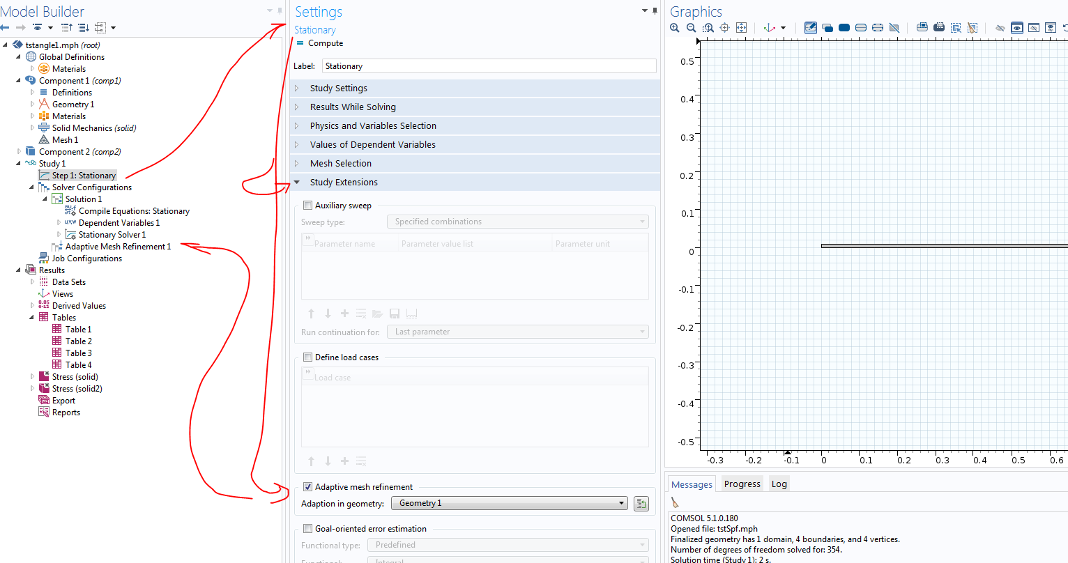

Posted: 10 years ago 2015/08/28 1:47 GMT-4
its all in the solver node, under "Study Extensions"
Check the corresponding doc, it still needs some tweaking to adapt to your model, but start with the default values
Hi its all in the solver node, under "Study Extensions" Check the corresponding doc, it still needs some tweaking to adapt to your model, but start with the default values -- Good luck Ivar
