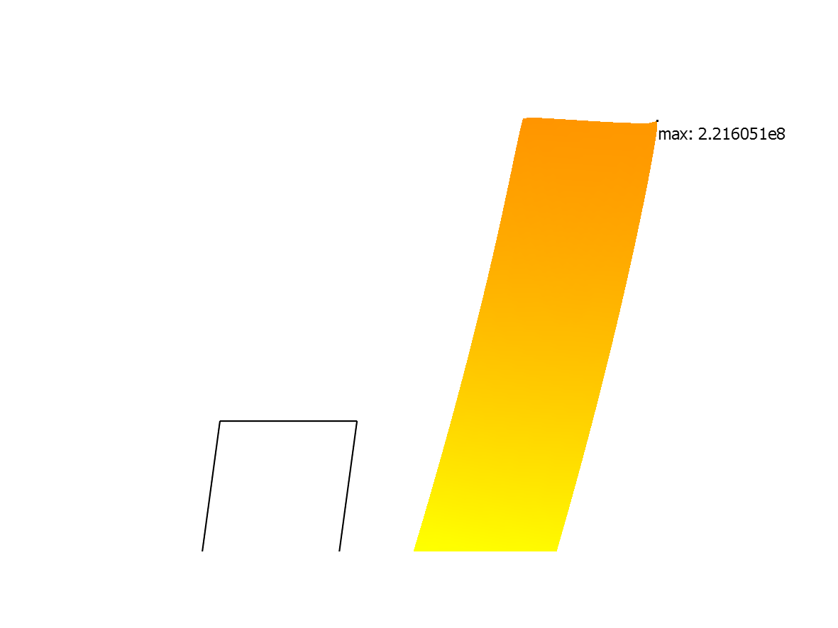

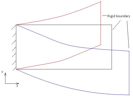

I was wondering how can I set a boundary constraint such that allows the boundary to displace parallel to any specific axis. For instance if I have a box, the right hand side should displace parallel to 'y' axis due to some known force.

in the structural module v3.5a you have the "prescribed displacemnt" BC (boundary Considition) which allows you to block one or several global coordinates directions x,y,z. This means basically that u,v or w will be = 0
If you want to block it along a line at i.e 45° you need to write out an equation for that, linking the coordinates, or easier you define your own rotated "Options - Coodinate System" and you define your displaceent in thsi coordinate system.
If you do not have the structural module, you basically have to write out the equations in the boundary conditions GUI, this is an excellent exercicie to learn how Comsol works internally
Hope this help

I have the structural module v3.5a, and I've been using the prescribed displacement BC, but I can not achieve my goal. Actually, what I need is a boundary condition of a super rigid wall (see example in attachment), which should not bend (must be parallel to 'y' axis), but it can move in any direction due to some external force.
I also tried with a new Coordinate System, but I haven't been able to obtain this result.

whell the nice (exceptional) thing with COMSOL is that you still have the "weak form"
Somewhere in the doc, I just cannot identify where just now, there is an example of a prismatic bar where on is restraining one edge to stay straight.
It means adding a global eaution setting the displacement of the edge/boundary to =0
Take a search, will be back when/if I find it : here it is
It's from page 84 and on in the V3.5a smeug.pdf
Once you have mastred the principle you willsee it's easy ;)
good luck

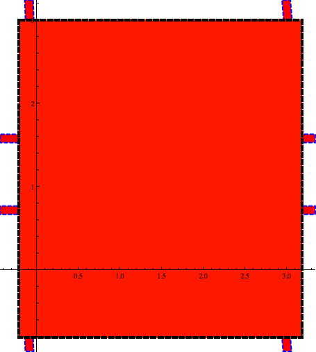

let mi join in. I did just as in example from smeug.pdf, but for 2D case, but what I get is not exactly what I want. I use ideal constraints, weak constraints are off. Any idea why the boundary of the deformed solid is not a straight line?
This straight line constraint is the only condition for this boundary.

thank you for the answer. Let me quickly introduce the problem. In model.png there is a periodic unit cell. No matter what happens inside the cell, ends of these ''beams`` should remain compatible in terms of translation the unit cell. In other words the boundaries should be the same due to the periodicity (right-left, top-bottom).
My plan was to put left and bottom beams ends on the roller. For right ends there is a prescribed Rx and free Ry.
Until now we have all ends horizontal or vertical. The only boundaries to be constrained are the upper ends of the beams. That's why I wanted them to stay horizontal. But I realize this approach is not perfect.
Do you have an idea how my goal could be achieved?

Yes probably it's the "roller" condition you want, which is implemented as the other conditions with a weak constraints, see the "Physics - Equations systems - Boundary Settings - Weak tab" and change the boundary conditions, use a name or a value such as Rx and Ry or 1 and 2 for the displacements to distinguish them from the "0", as there are already many of those "0", otherwise the formulas will not be completed ;)
If you need a combination forced displacement and roller you must set up the equation yourself. There are a few examples in the doc, we discussed one with a rigid edge in an otherwise flexible beam in another threads, its also well described in the doc

What if I would like the distance between all respective ("interacting") boundaries to be equal after the deformation? If x1, u1 and x2, u2 refer to left and right boundary respectively than one could write Derivative[x1+u1-(x2+u2),y]=0, what should keep the distance constant along y axis. v1 would be the master to v2 in other periodic condition.
Is this possible to implement? Should the global equation be used? And what mapping of vars is to be used?

First remark, I'm getting confused with your notations. I try to stick strictly to the COMSOL convention xyz for space coordinates, uvw for displacements and then use subscipt 1234 to identify the different items, it's easier to read that way.
I believe the periodic conditions are build up like you want it. You can use the same method to check what COMSOL is doing to the weak formulas as described above. So yes I'm sure this is implementable, (might be already by COMSOL).

Posted: 2 decades ago 2010/04/09 3:37 GMT-4
In fact I'm realising only now, what you are asking for is a "zero rotation Rz" since you allow the motion in "x" and "y" but you do not want the line to ROTATE.
This is possible on a free boundary with some tweaking of the equations. For some reason (still not 100% sure why, could be that its only of specific use in structural hence not "general enough" for the COMSOL developers, but pls do not hesitate to remindthem so this will once be implemented for the structural !!) the antisymmetric tensor representation of the deformations is not implemented, you have to write it out by hand yourself. The antisymmetric tensor is the local infinitisemal rotations.
In 2D the Rz or rotation along the Zaxis perpendicular to the X-Y plane is the value thz=0.5*(vx-uy) set this as a "Global Expression" in your model.
This is typically explained in books like: "Elasticity, Tensor, Dyadic, and Engineering approaches" by Pei Chi Chou & N.J. Pagano, Dover 1967, chap 2.5, or Theory of elasticity S.P. Timoshenk, J.N. Goodier, ch7 §83 or compare with the definition of the symmetric strain tensor
Then, once you have defined the variable thz, you need to constraint your boundary. This I have only found the "hard way" to edit the equations, by selecting the boundary(ies) (normally it's defined as free but might have an additional load) and then go into the "Physics - Equation systems - Boundary systems - Weak tab"
Edit the CONSTR line (in 2D SMPN there are 3 items for x,y,p, select the y and write "thz" instead of the value "0". This will force that thz=0 hence the angle should not change.
You still need to update the CONSTRF by replacing the second "0 by test(thz), which will adjust reaction forces to get the rotation to remain unchanged. By changing the equations in this matter you will see a small "lock" on the boundary index. This mesn that we have chnaged the eqautzions ina way COMSOL cannot "understand" and locks the boundary equations to avoid "automatic changes". You can always revert to standard COMSOL values by hitting the reset equation tab to the left of the GUI.
That's it you have blocked the rotation along Rz for the selected boundaries (edges in 2D), you can solve and study the result.
It's also applicable to 3D with the corresponding "thx" and "thy" angles. Its usefull with torque loading, but it ends up with many equations, would really have liked to have this "inside" the structural module by default :).

Posted: 2 decades ago 2010/04/09 4:46 GMT-4
Hi again,
I have added a second model with Euler beams added, to better see the analogy, as COMSOL solves the angles for the beams.
With the beams you have moments loads defined in COMSOL, with the angles th (2D).
Compare the "Physics - Equation system - Boundary Settings" of the "Smpn" and the "Physics - Equation system - Point Settings" of the "Smeulip"
Have fun COMSOLING
