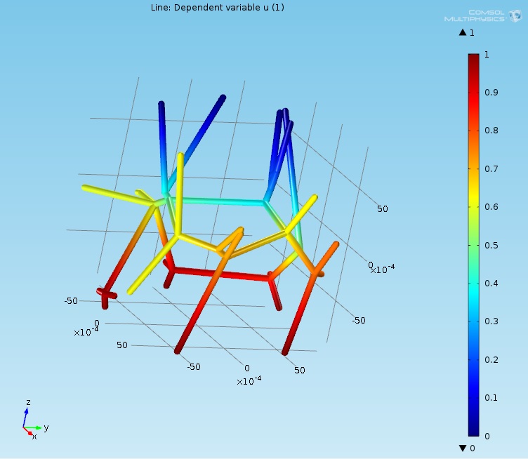

I have a network of 1D elements and I have modeled the current flow inside them using Coefficient from edge PDE. So after running the model I have the voltage in all the structure as shown in the picture.
now I need to calculate current in each branch of the structure. I'm wondering how I can do this. I know that current can be shown in a plot by:
sqrt(uTx^2+uTy^2+uTz^2)/(rho/A)
in which uTx,y,z are the voltage gradient and rho is the resistivity and A is the area of the cross section of each line.
but how can I derive the values?

as the cross section is constant we have constant current through each line, so I was thinking to use point evaluation but I need help how to do it.

I used arrow lines. it was good for showing the current direction. however I want to do something similar to line integration that is used to get the total heat flux in 2D, for example here:
www.youtube.com/watch?v=N784M5Mkp0o
I want to do the same, how ever on the boundary points to get the total current.

Dear Ehsan,
what do you mean by "derive it"? Would you like to export the data as txt file, display the values graphically ... ?
Please note that tangential derivatives are not defined in points but only on edges, because points have no tangent.
There is however a way to derive the current in a point "on the side of a neighbroung edge".
Take for instance in the model I sent earlier and attach here again point 7. It is connected to the edges 10, 12 and 7.
If you want to know the current in point 7 on the side of edge 12, you can access that by using a point evaluation for the expression
side(12,sqrt(uTx^2+uTy^2+uTz^2))*(rho/A)
I have addeed that to the file attached. Hope that helps.

I need to get the total current in the structure.
I can do it by exporting the data of the arrow lines plot (for the edges connected to the boundary points) but I have to choose them manually, which is not actually practical when I go to my bigger models.
So the best choice(in my opinion) is to choose the same nodes of the constraint(u-1 or u-0) and find the total current. However I'm not sure if this is the right way.

Sorry I didnt see your message completely. Yes this is exactly what I want. is there a way to find the current in all the edges(or any) connected to point 7?
so I can use it automatically for a set of points.
By the way, I have searched a lot to find a list of these kind of expressions. Are they listed somewhere in the documentations.
