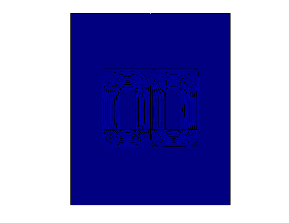

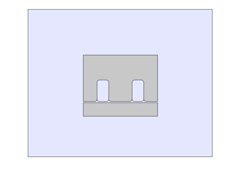

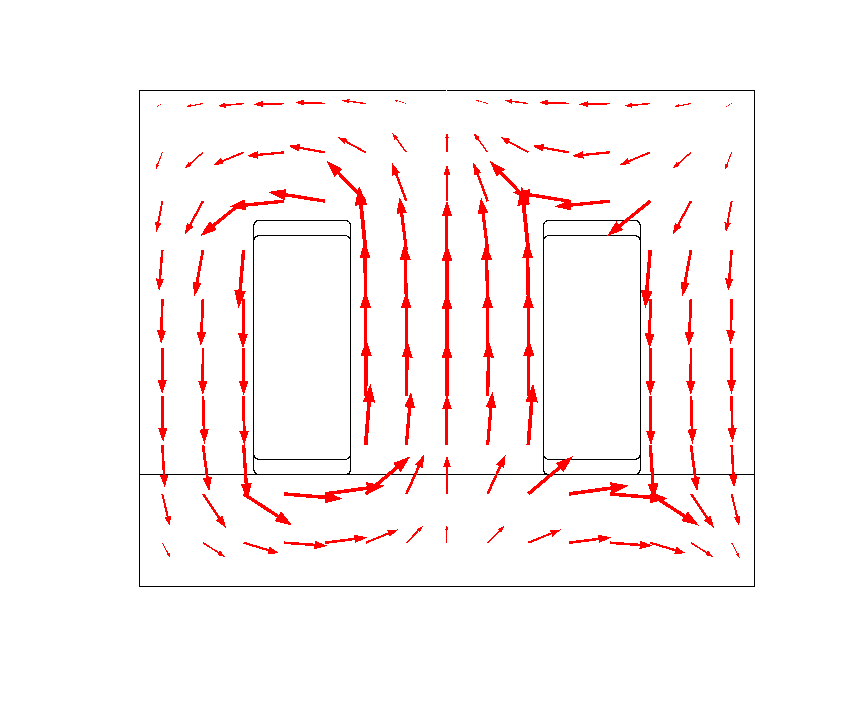

I'm dealing with a very simple problem that has been very frustrating for me! I would appreciate if any one can assist me with that.
I'm modeling an E-shaped core in 2D magnetic field module. It has a flat rectangular armature that is to be attracted by the magnetic force produced by the coil. I attached the schematics.
I've faced some problems and have some questions regarding that.

Posted: 1 decade ago 2013/03/29 5:50 JST
force calculations are dependent on the meshing, and also on all sharp corners as here the filed is undefined (what is the derivative at an vertex, in which direction ?
Often by rounding off corners you get better results.
Then when simulating objects that move, be aware NOT to change the topology, leave a small air gap so that the geometrical ID of each entities remains
Anyhow force simulations is based that you surround your force calculation item by all air around it, multiple mu_r domains around the boundaries to integrate will give errors in the force calculations

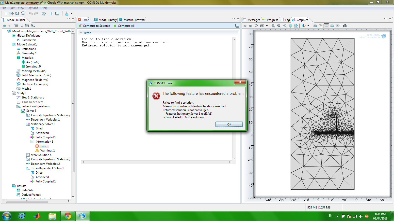

Posted: 1 decade ago 2013/04/02 3:58 JST
Thanks Ivar for the quick reply.
I could read the impedance. I also could connect my system to the circuit. Every thing looks fine; But, I don't know how I can solve different modules at the same time.
I added some ODEs replacing my structural mechanics module. Firstly, I cannot use my ODEs' states to define my geometry. my ODEs define how the armature moves and it affects the system's magnetic properties. So, the position of the armature is one of the states that is changing in the ODEs. Do you know any alternative or any modification on how I can use it as the position of an object in my geometry.
Considering I could resolve the problem above, now, I have 3 studies that I can solve separately. Since my armature is moving and I want to see its effect on the voltage in the circuit, I need to observe the effect of my ODEs -that define the motion of the armature- on the magnetic environment and the circuit.
I could run every single studies one by one (With fixed armature!). But, the results are not coupled. I think there is something I'm missing. I hope you or any one else could help me with that.
Thanks so much.
Vahid
Thanks Ivar for the quick reply. I could read the impedance. I also could connect my system to the circuit. Every thing looks fine; But, I don't know how I can solve different modules at the same time. I added some ODEs replacing my structural mechanics module. Firstly, I cannot use my ODEs' states to define my geometry. my ODEs define how the armature moves and it affects the system's magnetic properties. So, the position of the armature is one of the states that is changing in the ODEs. Do you know any alternative or any modification on how I can use it as the position of an object in my geometry. Considering I could resolve the problem above, now, I have 3 studies that I can solve separately. Since my armature is moving and I want to see its effect on the voltage in the circuit, I need to observe the effect of my ODEs -that define the motion of the armature- on the magnetic environment and the circuit. I could run every single studies one by one (With fixed armature!). But, the results are not coupled. I think there is something I'm missing. I hope you or any one else could help me with that. Thanks so much. Vahid

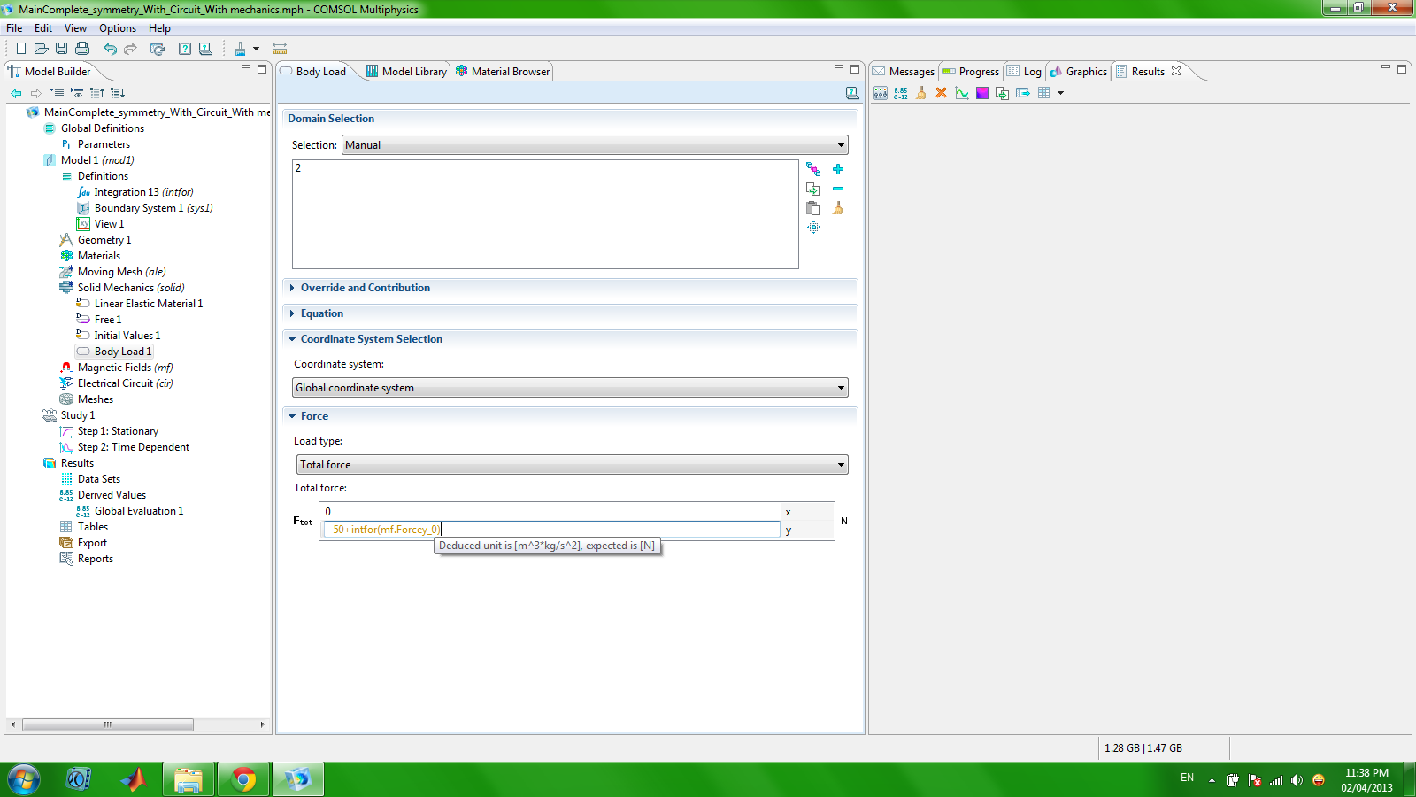

I defined an integration on the armature plate to measure the total magnetic force applied to it. When I want to use this integration in a formula, it shows up in orange text. I know that it does work with it, however, when I hold my mouse on it it tells me that the unit it can deduce from my expression is not Newton. (Please, see attached picture)
I think I'm not wrong about the formula. Do you have any idea what it can be generated from?

Posted: 1 decade ago 2013/04/03 14:51 JST
orange is unit warning (not considered as an error but might give wrong resultsif COMSOl does not interprete the values as you expect), your "50" has no units, so write rather 50[N] and then check that the units of your function or integration is ending up in N or you might have N/m and then you need to multiply by the 2D depth (probably 1[m]) to get the orange warning to turn blac (=OK)
Hi orange is unit warning (not considered as an error but might give wrong resultsif COMSOl does not interprete the values as you expect), your "50" has no units, so write rather 50[N] and then check that the units of your function or integration is ending up in N or you might have N/m and then you need to multiply by the 2D depth (probably 1[m]) to get the orange warning to turn blac (=OK) -- Good luck Ivar

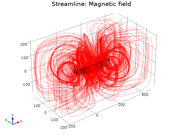

Posted: 1 decade ago 2013/04/05 3:58 JST

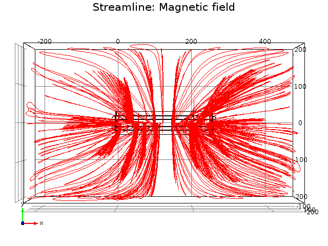

Hello Ivar

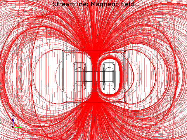

I modeled my system in 3D as well.
The force that I observe is way less than what I expect! The armature is surrounded fully by air.
Also, when I sketch the streamlines, they don't seem symmetric! The system itself is symmetric. (Please see the attachments)
Any clues?
Thanks
Hello Ivar I modeled my system in 3D as well. The force that I observe is way less than what I expect! The armature is surrounded fully by air. Also, when I sketch the streamlines, they don't seem symmetric! The system itself is symmetric. (Please see the attachments) Any clues? Thanks

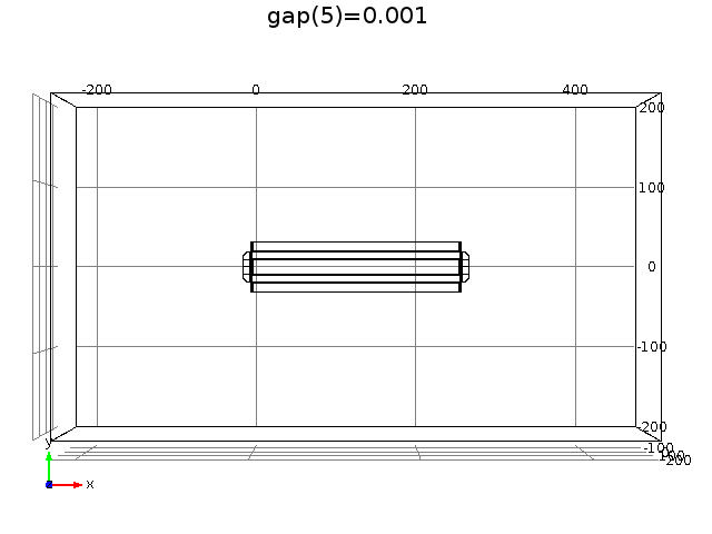

Posted: 1 decade ago 2013/04/05 6:05 JST
first of all from that angle it's not clear how they loop around, then you must play with the plot settigs, the source, the densities, how the stream lines are started and distributed
Hi first of all from that angle it's not clear how they loop around, then you must play with the plot settigs, the source, the densities, how the stream lines are started and distributed -- Good luck Ivar
Posted: 1 decade ago 2013/04/05 6:21 JST
Hello Ivar
Stream lines are Magnitude based and are for the Magnetic flux density!
I attach the 3D view here. I also attach the front view. I don't know why I don't get a symmetric result although the model is symmetric!
Thanks
Hello Ivar Stream lines are Magnitude based and are for the Magnetic flux density! I attach the 3D view here. I also attach the front view. I don't know why I don't get a symmetric result although the model is symmetric! Thanks
Posted: 1 decade ago 2013/04/05 6:27 JST
looks good like that, to perform better line selection you must study the different tabs on the GUI for the streamline plot, you might get also some hints from the videos on themain COMSOL site
Hi looks good like that, to perform better line selection you must study the different tabs on the GUI for the streamline plot, you might get also some hints from the videos on themain COMSOL site -- Good luck Ivar

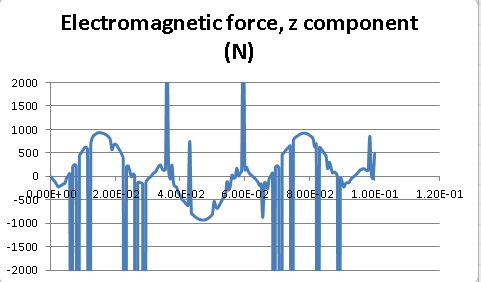

I did what you told me and it worked. When I apply the force as a boundary load it works fine; but the hanging problem arises when I do it as a body load.
Any clue?

Posted: 1 decade ago 2013/04/13 8:46 JST

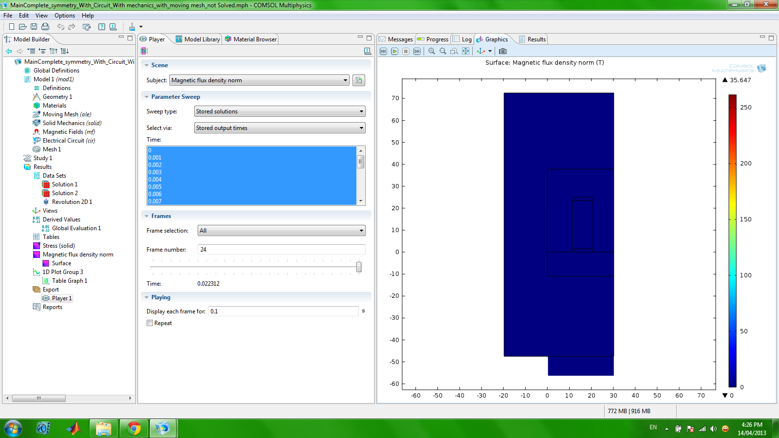

Hello
In the post-processing, when I extract an animation, it does show the magnetic flux; but the movement of my armature is not shown.
In the past, I could get the magnetic and structural mechanics results (Movement of the armature) in the same animation. I cannot remember how I did it! :)
Do you know how I can do this?
Thanks a lot.
Hello In the post-processing, when I extract an animation, it does show the magnetic flux; but the movement of my armature is not shown. In the past, I could get the magnetic and structural mechanics results (Movement of the armature) in the same animation. I cannot remember how I did it! :) Do you know how I can do this? Thanks a lot.

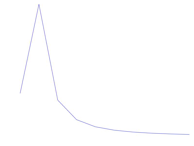

Posted: 1 decade ago 2013/04/13 8:55 JST
I attache the animation I extracted. This may help.
As you can notice, the armature's movement cannot be seen!
I attache the animation I extracted. This may help. As you can notice, the armature's movement cannot be seen!

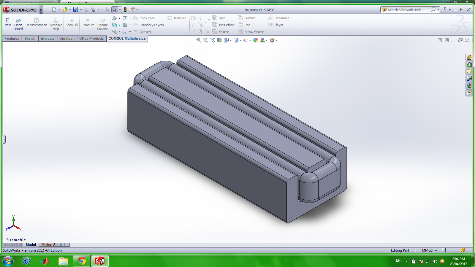

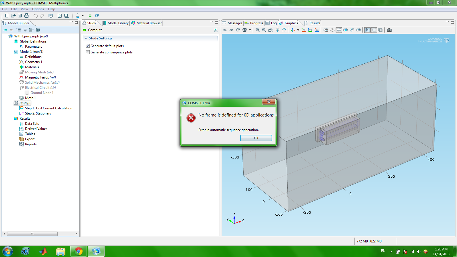

Hello Ivar
I'm trying to do the 3D modeling now. I noticed that everything is fine until I add the Electric circuit module. Even when I disable it, when I want to access the solver, it shows me an error saying " No frame is defined for 0D application". I am pretty sure it has something to do with the electric circuit module as when I delete it, the problem is resolved!
This is exact same problem in this forum:
www.comsol.com/community/forums/general/thread/34984/
But, there is no solution for it, what so ever!
Do you have any idea where this problem may have arisen from?
Thanks

Posted: 1 decade ago 2013/04/14 17:59 JST
Indeed I agree the 0D equations are typically the electric circuit ones, probably there is a node linke iisue as you cannot graph your node/net map it's easy to make errors. On the other side, if you have "just a resistance or a source you can model these without the CIR phyiscs too, it's only when yo have a comlex load, or a full feedback circuit loop that I use CIR physics, for that it is very nice, but a AC source term or a simple resistive load can be added as a weak constraint too
Hi Indeed I agree the 0D equations are typically the electric circuit ones, probably there is a node linke iisue as you cannot graph your node/net map it's easy to make errors. On the other side, if you have "just a resistance or a source you can model these without the CIR phyiscs too, it's only when yo have a comlex load, or a full feedback circuit loop that I use CIR physics, for that it is very nice, but a AC source term or a simple resistive load can be added as a weak constraint too -- Good luck Ivar
Posted: 1 decade ago 2013/04/15 0:55 JST
But, my electric circuit is disabled! Why does Comsol care about it?
Hi But, my electric circuit is disabled! Why does Comsol care about it?

Hello Ivar
Could you please take a look at the attached picture and see what is happening when I try to run a player! :)
The armature's boundaries do not move; but the body moves! The picture should be clear. you can see the boundaries are attached to the core but the body can be seen at the bottom coming out of the surrounding air! :)
Thanks
Hello Ivar Could you please take a look at the attached picture and see what is happening when I try to run a player! :) The armature's boundaries do not move; but the body moves! The picture should be clear. you can see the boundaries are attached to the core but the body can be seen at the bottom coming out of the surrounding air! :) Thanks
Posted: 1 decade ago 2013/04/15 13:59 JST
sorry but from what you show there I cannot see anything "obvious and wrong" but the details are in the numerous sub nodes, the way the ALE and Solid is linked, the solver continuation / parametric sweep settings and many more
Hi sorry but from what you show there I cannot see anything "obvious and wrong" but the details are in the numerous sub nodes, the way the ALE and Solid is linked, the solver continuation / parametric sweep settings and many more -- Good luck Ivar
Posted: 1 decade ago 2013/04/16 1:20 JST
Hi Ivar
I just wanted to show how the armature goes out of the air. you can see it at the bottom of the page! I did not link ale with solid specifically! I thought comsol does it automatically! Am I supposed to do anything to link them?
Hi Ivar I just wanted to show how the armature goes out of the air. you can see it at the bottom of the page! I did not link ale with solid specifically! I thought comsol does it automatically! Am I supposed to do anything to link them?
Posted: 1 decade ago 2013/04/16 18:49 JST
but that can be as well postprocessing and graphics, as well as true model dependent (in which case it shows rather that you have missed a BC or some definitions in the ALE)
Hi but that can be as well postprocessing and graphics, as well as true model dependent (in which case it shows rather that you have missed a BC or some definitions in the ALE) -- Good luck Ivar
Posted: 1 decade ago 2013/04/23 7:01 JST
Hi Ivar
I removed the solver and attached a clean file.
I would appreciate it if you could take a look and tell me what I'm doing wrong. I'm referring to the animation that does not show the motion of the armature (Mentioned before)
You need to run the file first.
Thanks
Hi Ivar I removed the solver and attached a clean file. I would appreciate it if you could take a look and tell me what I'm doing wrong. I'm referring to the animation that does not show the motion of the armature (Mentioned before) You need to run the file first. Thanks
Posted: 1 decade ago 2013/04/23 9:58 JST
Also, the magnetic flux density lines look a little awkward except for t=0 and at the end!
Do you know why that happens?
Also, the magnetic flux density lines look a little awkward except for t=0 and at the end! Do you know why that happens?
Posted: 1 decade ago 2013/04/23 18:16 JST
I have several issues here:
1) you are in 2D and not 2D axi, and your coil is a simple wire its not "looping around", is that so ?
2) you are mixing many physics and their linking is not correct, you are starting very though
My advice is to start again, but one physics at the time, i.e. first set up your coil and iron + air and do a MF and get theat running, then try only with solid, see if you acn get the fixed and mobile part to stay respectively fall off with a gravity load
then only try to combine.
There are far too many things to correct for me in your present model
Hi I have several issues here: 1) you are in 2D and not 2D axi, and your coil is a simple wire its not "looping around", is that so ? 2) you are mixing many physics and their linking is not correct, you are starting very though My advice is to start again, but one physics at the time, i.e. first set up your coil and iron + air and do a MF and get theat running, then try only with solid, see if you acn get the fixed and mobile part to stay respectively fall off with a gravity load then only try to combine. There are far too many things to correct for me in your present model -- Good luck Ivar

Posted: 1 decade ago 2013/04/24 3:05 JST
Thanks.
I have a coil; but isn't 2D-axi just for when I have an axis of rotation?
I attach the 3D view of my system. Armature will place on this part. This shows the core and the coil.
thanks
Hi Thanks. I have a coil; but isn't 2D-axi just for when I have an axis of rotation? I attach the 3D view of my system. Armature will place on this part. This shows the core and the coil. thanks
Posted: 1 decade ago 2013/04/24 18:29 JST
you are right, so you have a looong coil ;)
then 2D is correct but you should simulate a cut in the middle and use either a full "left" & "right" model or apply a correct symmetry /antisymmetry for the curent flow at x=0
Later you might consider 3D, but that demands far more CPU power and particularly time
Hi you are right, so you have a looong coil ;) then 2D is correct but you should simulate a cut in the middle and use either a full "left" & "right" model or apply a correct symmetry /antisymmetry for the curent flow at x=0 Later you might consider 3D, but that demands far more CPU power and particularly time -- Good luck Ivar

Posted: 1 decade ago 2013/05/16 1:40 JST
Hey Guys,
I am trying to get the force between a my armature and stator in a linear damper. I have attached a copy of my model.
In the armature I have an iron pole sandwiched by 2 permanent magnets. The coils are short circuited and as the magnets and iron are moving, the coils are being excited and generate a magnetic field to stop armature from moving. how can i calculate the total damping force that is applied to the whole armature?
There is a force calculation node in ACDC but I do not know whether I should applied to the whole armature or only magnets?
Assuming everything is solid with no deflection, Do I still need solid mechanic physics?
Can you give a a big picture here to start? is there a similar example?
PS. I have seen some example but none of them had this moving mesh that I have!
Thanks,
Ehsan

Posted: 1 decade ago 2013/05/16 3:57 JST
Hi again,
I have done something and I want to know whether that solves the problem or not!
I added a force calculation to mf domain and include the magnet and iron parts domains. the result is sinusoidal (and more than what it is supposed to be). Does it help? does it also calculate gravity or something?
Thanks,

Posted: 1 decade ago 2013/05/22 9:59 JST
It does not calculate the gravity but if you had defined it.
Check the property values in the material section.
Good Luck
