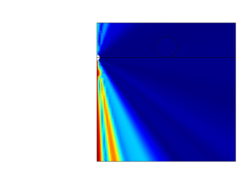

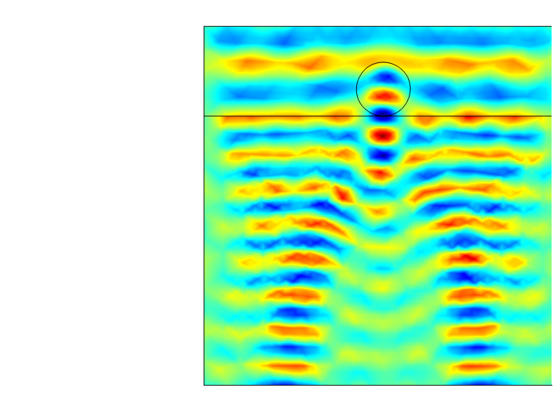

The plot for Hz makes sense but not the Far field plot.I assume there is some terrible mistake in my simulation as far as the result is concerned.Kindly Help
Without seeing the model and all the settings it is difficult to say what's wrong.

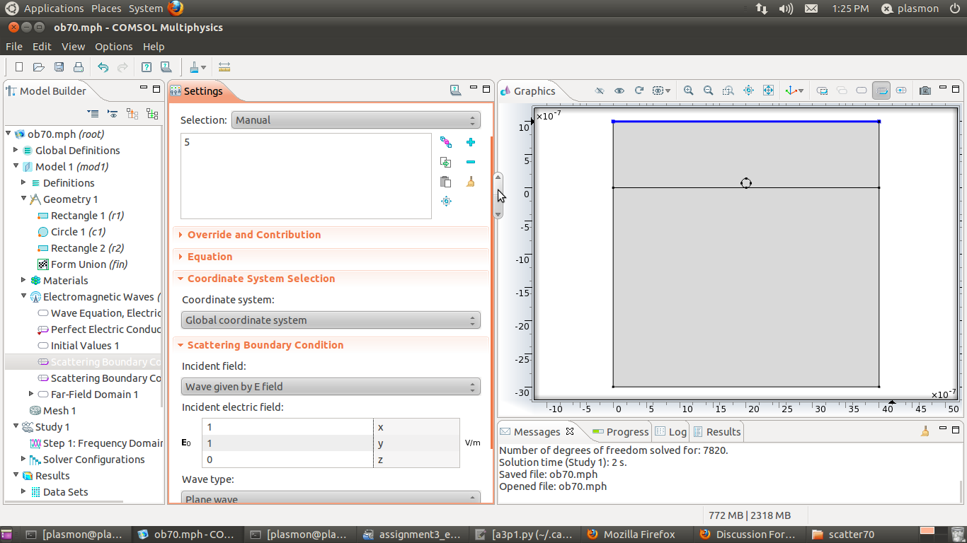

In the EM WAVE section I have taken the In-plane vector wave(want for TM case) and analyzing the total field(there is option of total field/scattered field).

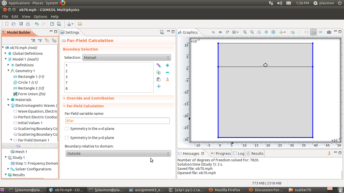

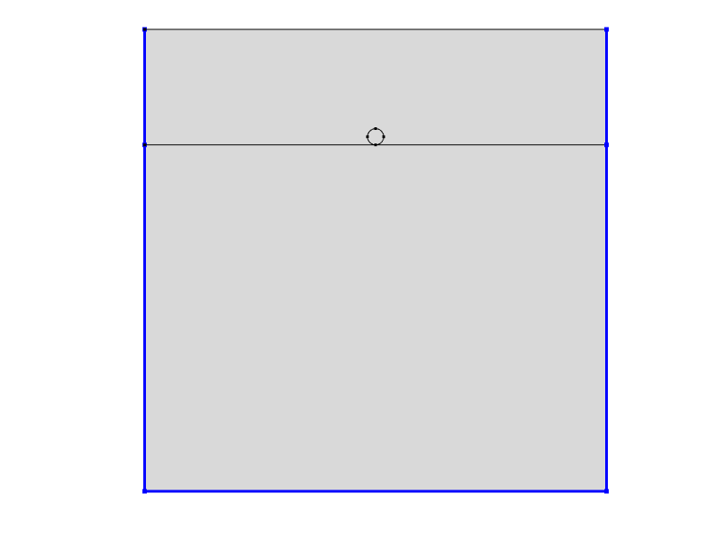

I am using scattering boundary conditions for my simulation domain boundaries (i don't know if that is correct/if something else might be appropriate)the sc1.png takes into account one scattering boundary and sc2.png takes into account the top boundary condition where light is excited.The farfield settings are shown(there might be some mistake here).(farfield.png)
What i have done is I have taken glass as my FAR FIELD DOMAIN SELECTION and taken the lowest boundary in my boundary selection .

The plots which i have obtained (HZ and Efarnorm) are the same which i have attached in the previous post.

I think the far field surface plot doesn't make much sense. You are probably interested in the far field along the bottom or lateral boundaries.
Try a 1D line plot along those boundaries and you will see that it gives reasonable results.
