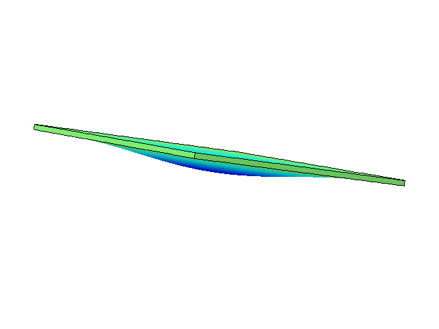

how to plot graph b/w preeure vs displacement
i need procedure how to plot grap for pressure sensor and how to observe pressure and displacement value......
1 Reply Last Post 2013/04/03 10:57 GMT-4
Posted: 1 decade ago 2013/04/03 10:57 GMT-4
eithjer define a point or an boundary, and get the average value (average operator or integration operator over a point, or over a Data Set "point") and then use the Results Derived values to get a table with pressure (as you probably changed it qwith a parametric sweep) and the average displacement. (or with the max displacement operator)
This is also described in some of the videos on the main site
