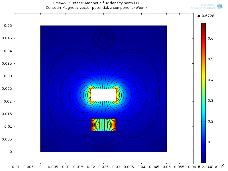

i have a "moving mesh" problem coupled with magnetic fields. I want to let the domain of a magnet move by a prescribed deformation in the ALE-Interface. It's a sinusoidal movement of a mass-spring-damper-system which i calculate by a global ODE and is used for the pescribed deformation.
If i couple the movement of the magnet with the magnetic field interface (mf) and do a time dependent study the magnet is moving by the correct displacement i calculate by the ODE but the result of the magnetic flux density is not moving or only the domain of the magnet is moving while using the spatial frame. I need the whole moving of the magnetic flux desinty in order to compute the inducted voltage of a coil.
Any advice to my problem? Thanks for your suggestions.
