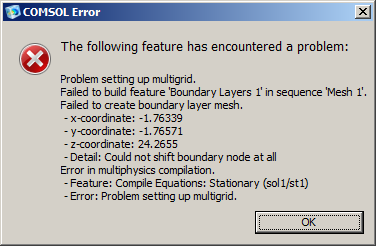

However, as I run the simulation (study 7-steady state) the following error appears:
Problem setting up multigrid.
Failed to build feature 'Boundary Layers 1' in sequence 'Mesh 1'.
- x-coord: -1.76
- y-coord: -1.76
- z-coord: 24.265
- Detail: Could not shif the boundary node at all
Description of the files allowing to reproduce the problem:
1) The error.png is a figure that shows the COMSOL error.
2) The 3D_laminar_8cores_1layer.mph is a COMSOL simulation where the mesh is successfully generated and that runs without problems.
