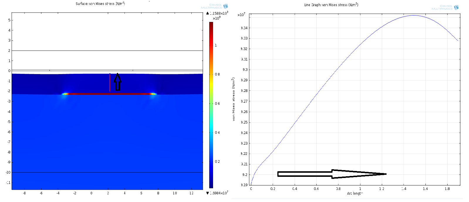

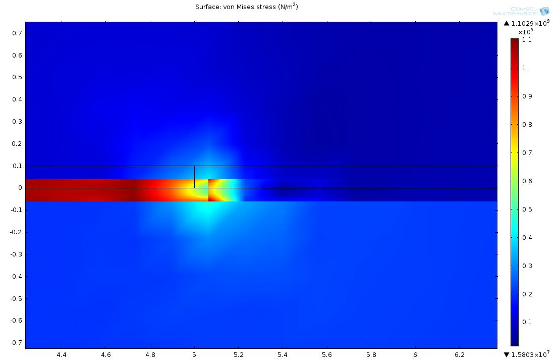

I applied the sweep mesh as you've suggested, and the compute result had much clearer boundaries, and lateral stress distribution. Thanks for the advise.
Yet, I still can't see clear stress gradient in vertical direction.
I expected a stress by thermal expansion mismatch to be generated above the Aluminum strip: a stress that will be the greatest right above the Al strip, and decay as it propagates upward.
But the compute results display a stress distribution plot that seems to have only point-like stress sources at the edges of the Al strip. I guess there still are some missing points in the model.
I would really appreciate it if you look over my model once again.
I applied the sweep mesh as you've suggested, and the compute result had much clearer boundaries, and lateral stress distribution. Thanks for the advise. Yet, I still can't see clear stress gradient in vertical direction. I expected a stress by thermal expansion mismatch to be generated above the Aluminum strip: a stress that will be the greatest right above the Al strip, and decay as it propagates upward. But the compute results display a stress distribution plot that seems to have only point-like stress sources at the edges of the Al strip. I guess there still are some missing points in the model. I would really appreciate it if you look over my model once again.

The model that I attached is a 2-D model with 10 elements across the thin Aluminum strip. Yet, I still can't obtain the appropriate stress gradient above the Aluminum strip in veritcal direction.
I checked the stress distribution above the Al strip using 1-D graph; it turned out the stress increases as it gets further from the Aluminum, which means there must be something wrong about the Physics module that I applied. But the problem is, I really can't figure out what the missing points are. I guess the mesh is dense enough and it's not the problem with mesh density. Can you help me out with this?
Thanks.
The model that I attached is a 2-D model with 10 elements across the thin Aluminum strip. Yet, I still can't obtain the appropriate stress gradient above the Aluminum strip in veritcal direction. I checked the stress distribution above the Al strip using 1-D graph; it turned out the stress increases as it gets further from the Aluminum, which means there must be something wrong about the Physics module that I applied. But the problem is, I really can't figure out what the missing points are. I guess the mesh is dense enough and it's not the problem with mesh density. Can you help me out with this? Thanks.

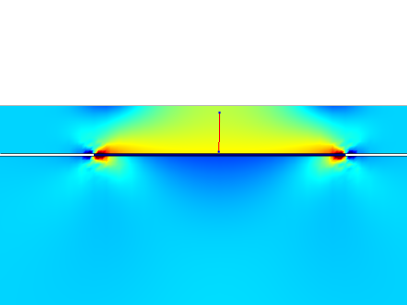

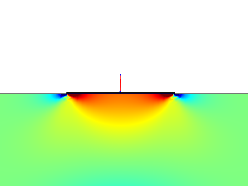

I eliminated SiO2 domain just left and right sides of Al strip, it sure is ridiculous and far from reality anyway.
Also one time I just attach Al strip on top of SiO2 domain.
From this I wanna see what happens there is no stress accumulation from Al strip pushing away SiO2 domain to horizontal direction.)
Then whole stress distribution looked like what I expected.
Stress distribution looks like elliptic gradient through medium.
I attached pictures.
So from this I have little bit of doubt that volumetric pushing away stress is largely over estimated than thermal expansion mismatch stress. So stress distribution what I expected was actually happened but it was screened by other factor.
In this manner "thin layer physics" way might be the proper solution to this problem. So can you explain little bit about that to this model?

analysing the stress means more than just plotting out the von Mises values (which are a combinations of the stress tensor components). Then do not forget that the Poisson coefficient changes the stress distribution if you looking at the far edge with material on only one side, or if you are looking at a cut in the middle of the material.
Check out the different stress tensor components too.
And do not forget to have a reasonable representation you need at least 3-5 mesh elements across the thickness of your layers. so check carefully the mesh dependence of your mode. (for that 2D is easier as this allows far denser mesh for a reasonable time to solve. I have just seen the video on 4.3b there seem to be now some new features allowing to easily cut a 3D model and run a 2D simulation on the cut plane, that I have been waiting for now for several years, finally, we will gain quite some time, and no need to go back to the CAD and save in the unstable DXF format ...

Because previous pictures that I attached few week ago were von mises and I forgot to mention that my last two pictures were x component of stress tensor.
I wanna see some lateral direction stress distribution.
As you can see stress in al strip is lower than SiO2 because it suffer from compressive stress. In von mises case Al region would be highest region.
I tried various kind of stress component and formats but in every cases left and right edge of strip have dominance over total stress distribution(and it decay relatively fast).
Also I use mapped mesh to give dense layer to the Al strip and near regions but main behavior was the same.
I tried a little bit with 3D model, still got the same results but I will try further soon.
Maybe my simple notion that "I would see elliptical stress distribution around Al strip" is too naive and results from COMSOL is actually accurate for situation.
Anyway I am happy to get more comments and any corrections.
