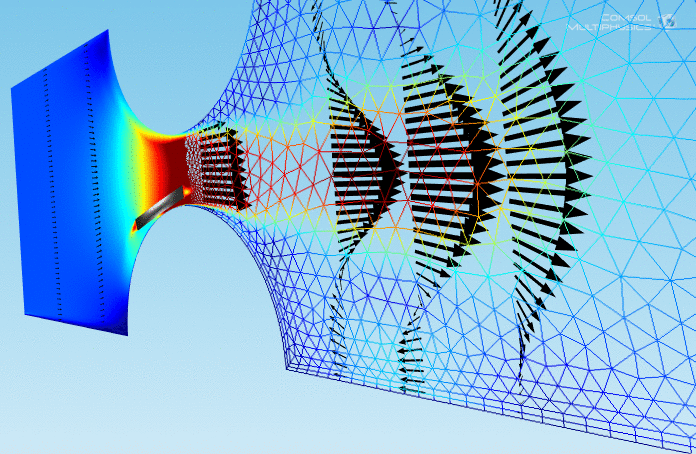

I have to simulate the displacement and rotation of a rigid prticule in a fluid flow and I am not a professional on comsol. So, is there anyone who could help me? or if you have any examples of this models.

You should have received the model corresponding to the image attached where the FSI interface is used to model a material of arbitrary shape in a flow. This model is not officialy supported by COMSOL since no checking has been made. Check carefuly your results!
(anyone interested by this model should get in touch directly with me).
This is relatively simple using the FSI that is available with the Structutral Mechanics module or the MEMS module. This is much more complicated if you do the coupling yourself (ALE + rigid or elastic body dynamics + fluid flow).

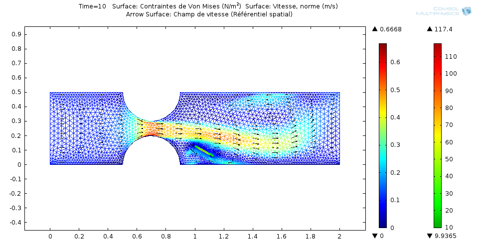

Actualy the 4.3b release introduces some slight improvements with the time-dependent algorithm and the reinitialization for the continuation of the computation just after a remeshing step is rather well under control. For others that have received the file before, you should ask for the updated version that has a much better control of accuracy in time. It makes the model much less sensitive to variations of parameters.
Attached a snapshot of the solution after 10s when the particle has traveled through the narrow central part.

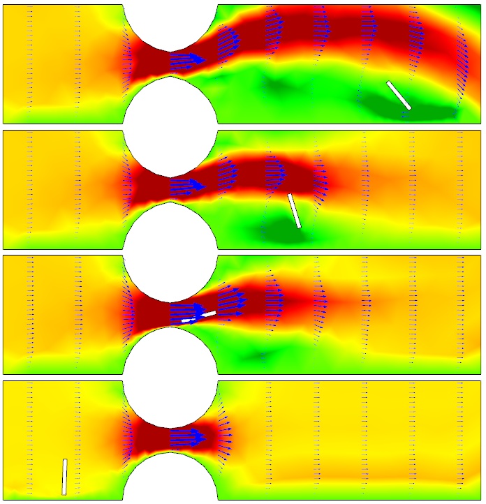

here is an updated animation with V4.4 (under resolved in time to make it smaller).
You should receive the file shortly through your contact in COMSOL.
