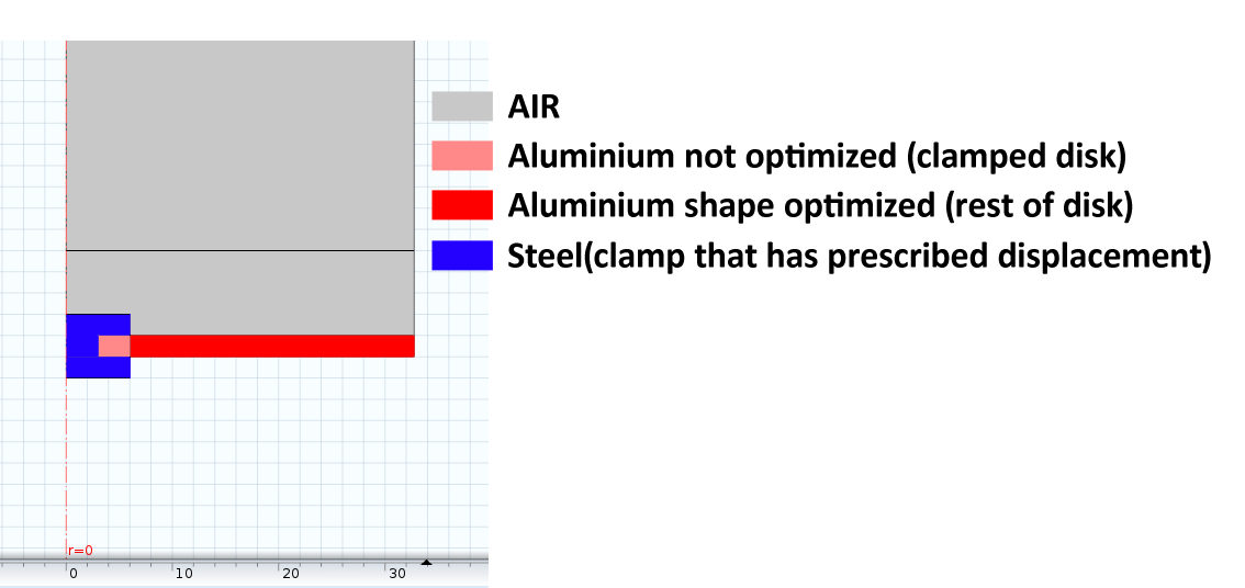

I'm currently optimizing the shape of a vibrating plate in an closed hollow cylinder filled with air to get an as straight as possible wavefront. I model it 2D axisymmetric and make use of solid mechanics and pressure acoustics in the frequency domain.
My plate is drawn as an rectangle and I only want the top line of the rectangle to be optimized, however now my whole shape (top and bottom line) of the rectangle are changed equally. Which is logic because I set a prescribed mesh displacement in z direction, but I don't know how to do it another way. I tried an parametric curve, but then the geometry and mesh aren't updated.

Can someone explain me how to optimize only the top line of the rectangle and keep the bottom and sides fixed?

PS the attachment is an overview of the geometry and the materials.
