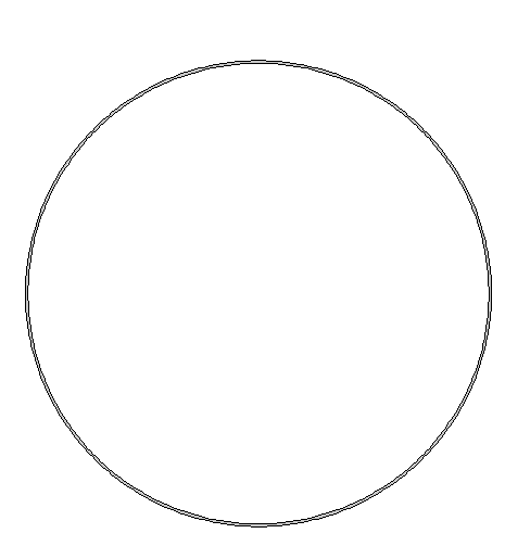

I'm not sure I fully understand what you are trying, a drawing or a model could make it easier to catch ;)
Please find attached the drawing of my model. It is just a simple ring. What I am trying is to look at the heat conduction only in radial direction by turning of tangential heat condcution. I have a coupled sturcutal mechanics module with my model. The structural part is not the problem. It is the heat equation I am trying to configure.

if you have a simple ring, then you can define a cylindrical coordinate system at the ring centre (Model - Definition Coordinate systems - Cylindrical coordinates) if this is then sys2, you have access to sys2.r (=sqrt((x-x0)^2+(y-yo)^2) if the axis is along Z, and x0,y0 are the centre offset) and to sys2.phi (=atan2(y,x) the angular variable hypotheses as before) and to sys2.z which is as Z
