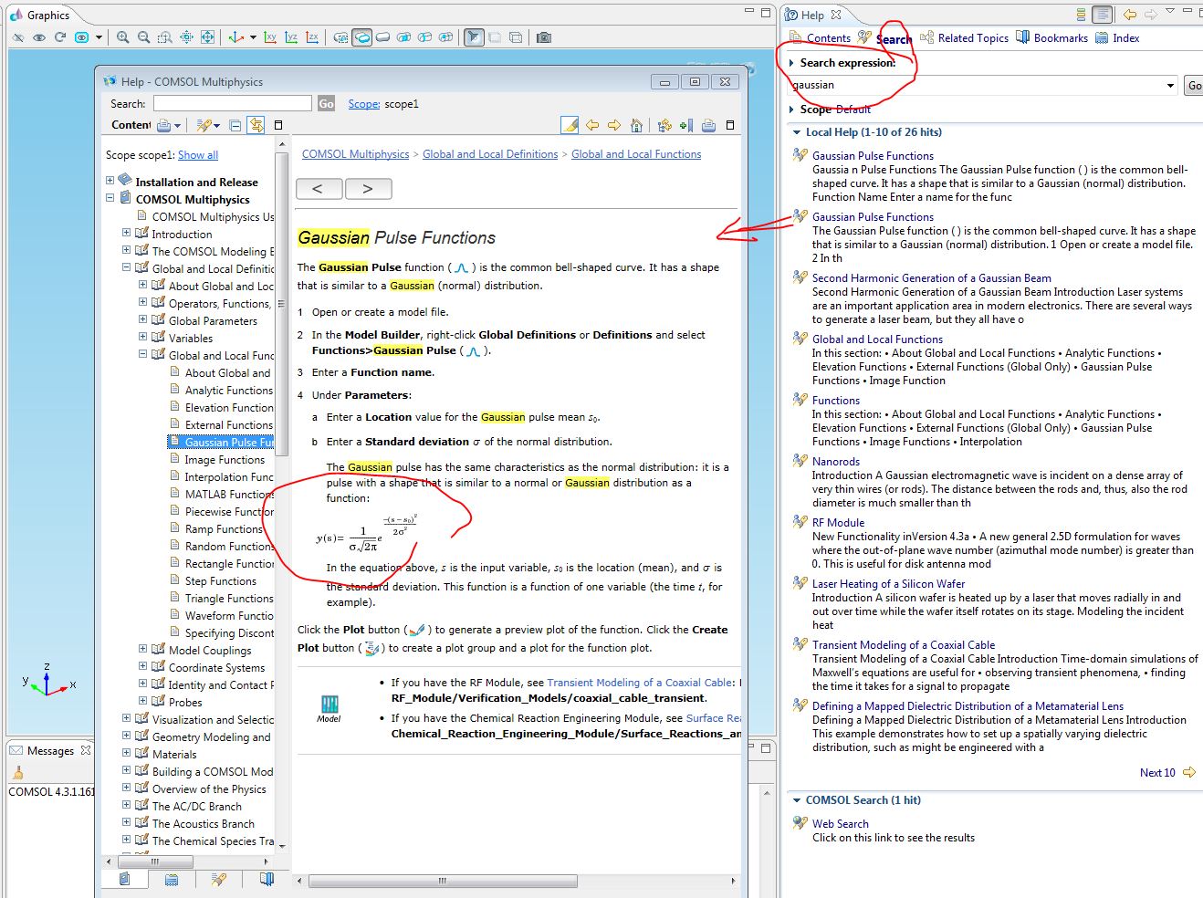

then you need to search a bit more in the help, the definition of the gaussian is in there but not on the first page about gaussian that appear, not sure why.
if you have a 2D gaussian for a 3Dmodel you need to define one for X and one for Y (or use the same one twice)

looks like this ;)
v4.3a.161
Thank you for your screen but i think that i read this page like 20 times and nevertheless i'm not getting any wiser, that's the analytical expression of the gaussian and not the way i should write it (normalisation) on Comsol but nevermind thank you for your time and your help, I hope I'll have my enlightenment moment.

Here is a link to a thread describing the Gaussian pulse: www.comsol.com/community/forums/general/thread/31879, in addition to the manual page that Ivar mentioned. The pulse can be in time or space, and if you want it in 2D or 3D you can take the product of Gaussian pulses in each dimension.
