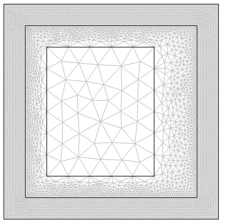

I have three subregions and mesh the subregions with different mesh size
(see attached figure).
After meshing i want to "remove" the internal boundaries
and keep the variable sized mesh.
At the end there should be only one subregion but the mesh should
stay "the same" as before.
How can I convert the internal boundaries to triangle edges
of a "combined mesh"?

I want to generate a mesh with variable mesh element size for semiconductor simulations.
My current approach is:
- Define a "mesh-size expression" mesh_size(x,y) in the scalar expressions.
- Copy the fem structure "fem" to a dummy fem structure "dummy_fem"
- Initialize the fem structure and calculate contour lines of the expression mesh_size(x,y).
- Take the contour lines as subdomain boundaries.
- Mesh the subdomains with different mesh sizes, according to the "countour-height".
- Remove the internal boundaries.
- Transfer the new mesh of "dummy_fem" to "fem", including all boundary conditions ect.
If i do not remove the boundaries i would have to specify the physics for a lot of regions
where the physics is the same.
Another approach was to start with a coarse triangle mesh and refine
the triangles if triangle-size is smaller than mesh_size(x,y). This
takes too much time and the mesh is too fine at some locations.
Is there a way to import a mesh without meshenrich?
If I find another way to get my wanted mesh point coordinates (and use the delaunay triangulation
function...) I would get the same problem with the mesh import.
So the main question is: "How to import a mesh for a already existing geometry?"

%get according coordinates
elem_coord_1=p(:,elem(1,:))';
elem_coord_2=p(:,elem(2,:))';
[n m] = size(elem_coord_1);
for k = 1:n
%get according dom numbers
x1=elem_coord_1(k,1);
y1=elem_coord_1(k,2);
xy1=[x1 y1];
x2=elem_coord_2(k,1);
y2=elem_coord_2(k,2);
xy2=[x2 y2];
edg.dom(k)=get_edg_boundary(new_geometry, xy1, xy2);
%calculate up-down subdomains
%calculate test point that lies left of boundary
epsi=3*eps;
if ~(abs(x2-x1)<epsi)
test_point_x=x1+(x2-x1)/2;
if x2-x1 > 0
test_point_y=y1+(y2-y1)/2+epsi;
else
test_point_y=y1+(y2-y1)/2-epsi;
end
elseif ~(abs(y2-y1)<epsi)
test_point_y=y1+(y2-y1)/2;
if y2-y1 > 0
test_point_x=x1+(x2-x1)/2-epsi;
else
test_point_x=x1+(x2-x1)/2+epsi;
end
else
msgbox('Error in mesh correction.');
end
%test if test point lies inside the subdomain polygon and set ud numbers
%create convex polygon
poly_ind=convhull(p(1,:),p(2,:));
poly_p_x=p(1,poly_ind);
poly_p_y=p(2,poly_ind);
%test and set ud number
edg.ud(1,k)=inpolygon(test_point_x,test_point_y,poly_p_x,poly_p_y);
edg.ud(2,k)=~edg.ud(1,k);
%transform param values from absolute distances to relative distances
%get length of boundary
XY1=flgeomed(new_geometry,edg.dom(k),0);
XY2=flgeomed(new_geometry,edg.dom(k),1);
bound_length=sqrt((XY2(2)-XY1(2))^2+(XY2(1)-XY1(1))^2);
%set param values
edg.param(:,k)=edg.param(:,k)/bound_length;
%check orientation and flip, if edg orientation is not equal boundary orientation
if ~and(isequal(XY2(1)-XY1(1)>epsi,x2-x1>epsi),isequal(XY2(2)-XY1(2)>epsi,y2-y1>epsi))
%flip elem
saveelem=edg.elem(1,k);
edg.elem(1,k)=edg.elem(2,k);
edg.elem(2,k)=saveelem;
%flip ud
saveud=edg.ud(1,k);
edg.ud(1,k)=edg.ud(2,k);
edg.ud(2,k)=saveud;
%calculate new param
edg.param(1,k)=1-edg.param(1,k);
edg.param(2,k)=1-edg.param(2,k);
end
end
%assign corrected mesh information-------------------------------------------------------------------------------------
el{1}=tri;
el{2}=edg;
el{3}=vtx;
fem.mesh=femmesh(p,el);
%assign new geometry---------------------------------------------------------------------------------------------------
fem.geom=new_geometry;
resultfem=fem;
end
function index = get_point(geometry,x,y,tol)
%This function finds the index of a point at given coordinates with tolerance tol
%index = get_point(geometry,x,y,tol)
%set default tolerance=================================================================================================
if nargin < 4
tol = eps;
end
% plot geometry =======================================================================================================
%geomplot(geometry,'pointlabels','on','edgelabels','on');
%get number of objects=================================================================================================
gd = geominfo(geometry,'out',{'gd'});
no = geominfo(geometry,'out',{'no'},'od',0:gd);
%get vertex coordinates================================================================================================
xy=flgeomvtx(geometry);
%get indice that lie in the region of interest=========================================================================
% getting elements with x-coordinate > x-tol
element_x_g = find(xy(1,:) >= x - tol);
% getting elements with x-coordinate < x+tol
element_x_s = find(xy(1,:) <= x + tol);
% creating a matrix for the elements greater x
coordinate_matrix_x_g = zeros(1,no(1));
% creating a matrix for the elements smaller x
coordinate_matrix_x_s = zeros(1,no(1));
% filling the matrix with a one when element fullfills the condition > x
coordinate_matrix_x_g(element_x_g) = 1;
% filling the matrix with a one when element fullfills the condition < x
coordinate_matrix_x_s(element_x_s) = 1;
% Merge the x-coordinate_s and x-coordinate_g matrix
coordinate_matrix_x = coordinate_matrix_x_g & coordinate_matrix_x_s;
% getting elements with y-coordinate > y-tol
element_y_g = find(xy(2,:) >= y - tol);
% getting elements with y-coordinate < y + tol
element_y_s = find(xy(2,:) <= y + tol);
% creating a matrix for the elements greater y
coordinate_matrix_y_g = zeros(1,no(1));
% creating a matrix for the elements smaller y
coordinate_matrix_y_s = zeros(1,no(1));
% filling the matrix with an one when element fullfills the condition > y
coordinate_matrix_y_g(element_y_g) = 1;
% filling the matrix with an one when element fullfills the condition < y
coordinate_matrix_y_s(element_y_s) = 1;
% Merge the y-coordinate_s and y-coordinate_g matrix
coordinate_matrix_y = coordinate_matrix_y_g & coordinate_matrix_y_s;
%% Calculating the Object which fullfills all the conditions x y
%get indice
index = find(coordinate_matrix_x & coordinate_matrix_y == 1);
if length(index) > 1
msgbox(['More than one point found in region around x = ' num2str(x,3) ', y = ' num2str(y,3) ],'Error','error');
end
if length(index) < 1
msgbox(['No point found in region around x = ' num2str(x,3) ', y = ' num2str(y,3) ],'Error','error');
end
end
function index = get_edg_boundary(geometry,p1,p2,tol)
%this function finds the boundary index of a edge element between the
%points p1 = [x1 y1] and p2 =[x2 y2]
%index = get_edg_boundary(geometry,p1,p2)
if nargin < 4
tol = eps;
end
%get coordinates of edges==============================================================================================
X1=0;
Y1=0;
X2=0;
Y2=0;
for k = 1:no
xy=flgeomed(geometry,k,0);
X1(k)=xy(1);
Y1(k)=xy(2);
xy2=flgeomed(geometry,k,1);
X2(k)=xy2(1);
Y2(k)=xy2(2);
end
%%calculate all boundary elements that may include the edg element in x-direction
% getting elements with X1 <= x1, X1 <= x2
element_x_s1 = find(X1 <= p1(1)+tol);
element_x_s2 = find(X1 <= p2(1)+tol);
% getting elements with X2 >= x1, X2 >=x2
element_x_g1 = find(X2 >= p1(1)-tol);
element_x_g2 = find(X2 >= p2(1)-tol);
% creating matrix for start_x smaller x_vals
coordinate_matrix_x_s1 = zeros(1,no(1));
coordinate_matrix_x_s2 = zeros(1,no(1));
% creating matrix for end_x greater x_vals
coordinate_matrix_x_g1 = zeros(1,no(1));
coordinate_matrix_x_g2 = zeros(1,no(1));
% filling matrix with a one when element fullfills the smaller condition
coordinate_matrix_x_s1(element_x_s1) = 1;
coordinate_matrix_x_s2(element_x_s2) = 1;
coordinate_matrix_x_s = coordinate_matrix_x_s1 & coordinate_matrix_x_s2;
% filling matrix with a one when element fullfills the greater condition
coordinate_matrix_x_g1(element_x_g1) = 1;
coordinate_matrix_x_g2(element_x_g2) = 1;
coordinate_matrix_x_g = coordinate_matrix_x_g1 & coordinate_matrix_x_g2;
%% calculate all boundary elements that may include the edg element in y-direction
% getting elements with Y1 <= y1, Y1 <= y2
element_y_s1 = find(Y1 <= p1(2)+tol);
element_y_s2 = find(Y1 <= p2(2)+tol);
% getting elements with Y2 >= x1, Y2 >=x2
element_y_g1 = find(Y2 >= p1(2)-tol);
element_y_g2 = find(Y2 >= p2(2)-tol);
% creating matrix for start_y smaller y_vals
coordinate_matrix_y_s1 = zeros(1,no(1));
coordinate_matrix_y_s2 = zeros(1,no(1));
coordinate_matrix_y_g1 = zeros(1,no(1));
coordinate_matrix_y_g2 = zeros(1,no(1));
coordinate_matrix_y_s1(element_y_s1) = 1;
coordinate_matrix_y_s2(element_y_s2) = 1;
coordinate_matrix_y_g1(element_y_g1) = 1;
coordinate_matrix_y_g2(element_y_g2) = 1;
coordinate_matrix_y_g = coordinate_matrix_y_g1 & coordinate_matrix_y_g2;
coordinate_matrix_y_s = coordinate_matrix_y_s1 & coordinate_matrix_y_s2;
% Addition of both matrices to get the element which is the searchobject
msgbox(['Error: More than one possible boundary found.' sprintf('\n') ...
'for the edg element between p1 = (' num2str(p1(1),3) ', ' num2str(p1(2),3) ') and' sprintf('\n') ...
' p2 = (' num2str(p2(1),3) ', ' num2str(p2(2),3) ') !'],'Error','error');
end
msgbox(['Error: No boundary found for the edg element' sprintf('\n') ...
'between p1 = (' num2str(p1(1),3) ', ' num2str(p1(2),3) ') and' sprintf('\n') ...
end
end
Hi, I solved my "funny indexing puzzle" :) The functions below might not work for all geometry and might be slow. However, they do the job for me and you may modify the functions for your own needs. - Save the attached functions and add them to your matlab path (Matlab menu: File=>Set Path...) - Export your fem structure to the Matlab workspace as "fem". - Run following command: fem=remove_internal_boundaries(fem) - Import the new fem structure "fem" back to the Comsol interface. Good luck! ******************************** function resultfem=remove_internal_boundaries(fem) %this function removes internal boundaries from a fem strukture and keeps the mesh %fem=remove_internal_boundaries(fem) %delete interior boundaries of geometry-------------------------------------------------------------------------------- new_geometry=geomdel(fem.geom); %geomplot(new_geometry); %read mesh information from fem---------------------------------------------------------------------------------------- el=get(fem.mesh,'el'); p=get(fem.mesh,'p'); %write triangle element information to new el structure---------------------------------------------------------------- for i=1:length(el) if isequal(el{i}.type,'tri') tri_elem=el{i}.elem; end end el_structure{1}=struct('type','tri','elem',tri_elem); %create new mesh ------------------------------------------------------------------------------------------------------ fem.mesh=femmesh(p,el_structure); fem.mesh=meshenrich(fem); %the new mesh has to be modified to fit the already existing geometry================================================== %read new mesh information from fem------------------------------------------------------------------------------------ clear el; clear p; el=get(fem.mesh,'el'); p=get(fem.mesh,'p'); tri=el{1}; vtx=el{2}; edg=el{3} %correct vtx information----------------------------------------------------------------------------------------------- %get elem vector elem=vtx.elem; %get according coordinates elem_coord=p(:,elem)'; [n m] = size(elem_coord); %get according dom numbers for k = 1:n vtx.dom(k)=get_point(new_geometry, elem_coord(k,1),elem_coord(k,2)); end %correct edg information----------------------------------------------------------------------------------------------- %get elem vector elem=edg.elem; %get according coordinates elem_coord_1=p(:,elem(1,:))'; elem_coord_2=p(:,elem(2,:))'; [n m] = size(elem_coord_1); for k = 1:n %get according dom numbers x1=elem_coord_1(k,1); y1=elem_coord_1(k,2); xy1=[x1 y1]; x2=elem_coord_2(k,1); y2=elem_coord_2(k,2); xy2=[x2 y2]; edg.dom(k)=get_edg_boundary(new_geometry, xy1, xy2); %calculate up-down subdomains %calculate test point that lies left of boundary epsi=3*eps; if ~(abs(x2-x1) 0 test_point_y=y1+(y2-y1)/2+epsi; else test_point_y=y1+(y2-y1)/2-epsi; end elseif ~(abs(y2-y1) 0 test_point_x=x1+(x2-x1)/2-epsi; else test_point_x=x1+(x2-x1)/2+epsi; end else msgbox('Error in mesh correction.'); end %test if test point lies inside the subdomain polygon and set ud numbers %create convex polygon poly_ind=convhull(p(1,:),p(2,:)); poly_p_x=p(1,poly_ind); poly_p_y=p(2,poly_ind); %test and set ud number edg.ud(1,k)=inpolygon(test_point_x,test_point_y,poly_p_x,poly_p_y); edg.ud(2,k)=~edg.ud(1,k); %transform param values from absolute distances to relative distances %get length of boundary XY1=flgeomed(new_geometry,edg.dom(k),0); XY2=flgeomed(new_geometry,edg.dom(k),1); bound_length=sqrt((XY2(2)-XY1(2))^2+(XY2(1)-XY1(1))^2); %set param values edg.param(:,k)=edg.param(:,k)/bound_length; %check orientation and flip, if edg orientation is not equal boundary orientation if ~and(isequal(XY2(1)-XY1(1)>epsi,x2-x1>epsi),isequal(XY2(2)-XY1(2)>epsi,y2-y1>epsi)) %flip elem saveelem=edg.elem(1,k); edg.elem(1,k)=edg.elem(2,k); edg.elem(2,k)=saveelem; %flip ud saveud=edg.ud(1,k); edg.ud(1,k)=edg.ud(2,k); edg.ud(2,k)=saveud; %calculate new param edg.param(1,k)=1-edg.param(1,k); edg.param(2,k)=1-edg.param(2,k); end end %assign corrected mesh information------------------------------------------------------------------------------------- el{1}=tri; el{2}=edg; el{3}=vtx; fem.mesh=femmesh(p,el); %assign new geometry--------------------------------------------------------------------------------------------------- fem.geom=new_geometry; resultfem=fem; end ************************************ function index = get_point(geometry,x,y,tol) %This function finds the index of a point at given coordinates with tolerance tol %index = get_point(geometry,x,y,tol) %set default tolerance================================================================================================= if nargin < 4 tol = eps; end % plot geometry ======================================================================================================= %geomplot(geometry,'pointlabels','on','edgelabels','on'); %get number of objects================================================================================================= gd = geominfo(geometry,'out',{'gd'}); no = geominfo(geometry,'out',{'no'},'od',0:gd); %get vertex coordinates================================================================================================ xy=flgeomvtx(geometry); %get indice that lie in the region of interest========================================================================= % getting elements with x-coordinate > x-tol element_x_g = find(xy(1,:) >= x - tol); % getting elements with x-coordinate < x+tol element_x_s = find(xy(1,:) x coordinate_matrix_x_g(element_x_g) = 1; % filling the matrix with a one when element fullfills the condition < x coordinate_matrix_x_s(element_x_s) = 1; % Merge the x-coordinate_s and x-coordinate_g matrix coordinate_matrix_x = coordinate_matrix_x_g & coordinate_matrix_x_s; % getting elements with y-coordinate > y-tol element_y_g = find(xy(2,:) >= y - tol); % getting elements with y-coordinate < y + tol element_y_s = find(xy(2,:) y coordinate_matrix_y_g(element_y_g) = 1; % filling the matrix with an one when element fullfills the condition < y coordinate_matrix_y_s(element_y_s) = 1; % Merge the y-coordinate_s and y-coordinate_g matrix coordinate_matrix_y = coordinate_matrix_y_g & coordinate_matrix_y_s; %% Calculating the Object which fullfills all the conditions x y %get indice index = find(coordinate_matrix_x & coordinate_matrix_y == 1); if length(index) > 1 msgbox(['More than one point found in region around x = ' num2str(x,3) ', y = ' num2str(y,3) ],'Error','error'); end if length(index) < 1 msgbox(['No point found in region around x = ' num2str(x,3) ', y = ' num2str(y,3) ],'Error','error'); end end **************************************** function index = get_edg_boundary(geometry,p1,p2,tol) %this function finds the boundary index of a edge element between the %points p1 = [x1 y1] and p2 =[x2 y2] %index = get_edg_boundary(geometry,p1,p2) %set default tolerance================================================================================================= if nargin < 4 tol = eps; end % plot geometry ======================================================================================================= %geomplot(geometry,'pointlabels','on','edgelabels','on'); %get number of objects================================================================================================= gd = geominfo(geometry,'out',{'gd'}); no = geominfo(geometry,'out',{'no'},'od',0:gd); %get coordinates of edges============================================================================================== X1=0; Y1=0; X2=0; Y2=0; for k = 1:no xy=flgeomed(geometry,k,0); X1(k)=xy(1); Y1(k)=xy(2); xy2=flgeomed(geometry,k,1); X2(k)=xy2(1); Y2(k)=xy2(2); end %%calculate all boundary elements that may include the edg element in x-direction % getting elements with X1 = p2(1)-tol); % creating matrix for start_x smaller x_vals coordinate_matrix_x_s1 = zeros(1,no(1)); coordinate_matrix_x_s2 = zeros(1,no(1)); % creating matrix for end_x greater x_vals coordinate_matrix_x_g1 = zeros(1,no(1)); coordinate_matrix_x_g2 = zeros(1,no(1)); % filling matrix with a one when element fullfills the smaller condition coordinate_matrix_x_s1(element_x_s1) = 1; coordinate_matrix_x_s2(element_x_s2) = 1; coordinate_matrix_x_s = coordinate_matrix_x_s1 & coordinate_matrix_x_s2; % filling matrix with a one when element fullfills the greater condition coordinate_matrix_x_g1(element_x_g1) = 1; coordinate_matrix_x_g2(element_x_g2) = 1; coordinate_matrix_x_g = coordinate_matrix_x_g1 & coordinate_matrix_x_g2; % Merge the x-coordinate_s and x-coordinate_g matrix coordinate_matrix_x = coordinate_matrix_x_g & coordinate_matrix_x_s; %% calculate all boundary elements that may include the edg element in y-direction % getting elements with Y1 = p2(2)-tol); % creating matrix for start_y smaller y_vals coordinate_matrix_y_s1 = zeros(1,no(1)); coordinate_matrix_y_s2 = zeros(1,no(1)); % creating matrix for end_x greater x_vals coordinate_matrix_y_g1 = zeros(1,no(1)); coordinate_matrix_y_g2 = zeros(1,no(1)); % filling matrix with a one when element fullfills the smaller condition coordinate_matrix_y_s1(element_y_s1) = 1; coordinate_matrix_y_s2(element_y_s2) = 1; % filling matrix with a one when element fullfills the greater condition coordinate_matrix_y_g1(element_y_g1) = 1; coordinate_matrix_y_g2(element_y_g2) = 1; % Merge the x-coordinate_s and x-coordinate_g matrix coordinate_matrix_y_g = coordinate_matrix_y_g1 & coordinate_matrix_y_g2; coordinate_matrix_y_s = coordinate_matrix_y_s1 & coordinate_matrix_y_s2; coordinate_matrix_y = coordinate_matrix_y_g & coordinate_matrix_y_s; %% Calculating the Object which fullfills all the conditions % Addition of both matrices to get the element which is the searchobject index = find(coordinate_matrix_x & coordinate_matrix_y == 1); if length(index) > 1 msgbox(['Error: More than one possible boundary found.' sprintf('\n') ... 'for the edg element between p1 = (' num2str(p1(1),3) ', ' num2str(p1(2),3) ') and' sprintf('\n') ... ' p2 = (' num2str(p2(1),3) ', ' num2str(p2(2),3) ') !'],'Error','error'); end if length(index) < 1 msgbox(['Error: No boundary found for the edg element' sprintf('\n') ... 'between p1 = (' num2str(p1(1),3) ', ' num2str(p1(2),3) ') and' sprintf('\n') ... ' p2 = (' num2str(p2(1),3) ', ' num2str(p2(2),3) ') !'],'Error','error'); end end
Posted: 2 decades ago 2010/03/15 5:35 GMT-4
Well why do you really want to remove the interiour boundaries, just leave them, no ?
As the mesh is related to your geometry there is no easy way around, from my knowledge you can only export the mesh as is and import it again, but then you loose the ability to easily play with it
But OK you have given us some interesting commands and scripts there, thanks for that !
Hi Well why do you really want to remove the interiour boundaries, just leave them, no ? As the mesh is related to your geometry there is no easy way around, from my knowledge you can only export the mesh as is and import it again, but then you loose the ability to easily play with it But OK you have given us some interesting commands and scripts there, thanks for that ! Good luck Ivar
