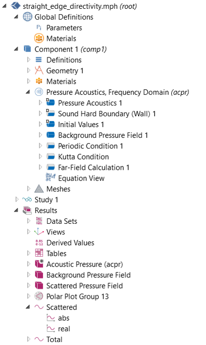

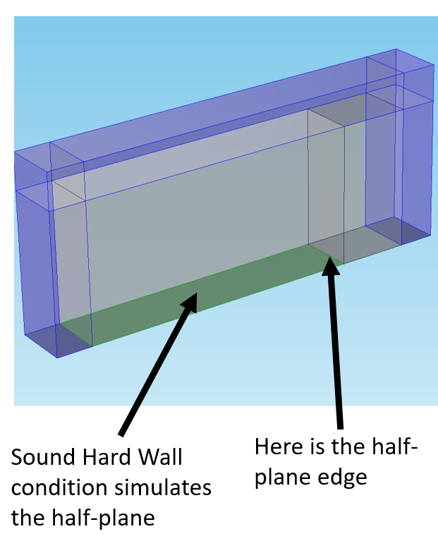

I am simulating the scattering of acoustic waves by a half-plane. The domain consists of a rectangular box with the half-plane at the bottom. The box is surrounded by PMLs shown in purple in the image below. Periodic boundary conditions are used in the front and back faces and the background field is a plane wave in the x-direction. I am using the pressure acoustics, frequency domain module and I would like to add a background mean flow in the x-direction.

I understand your point of view, however for validation of my simulation I must radiate the pressure on the plate to the far-field and compute the directivity patterns at different non-dimensional frequencies. I am trying to use the acoustic pressure, frequency domain since the far-field computation is straightforward using the far-field module (K-H integral). For the flow I can assume only inviscid and irrotational flow, so I guess it should be either linearized compressible or linearized Euler.
