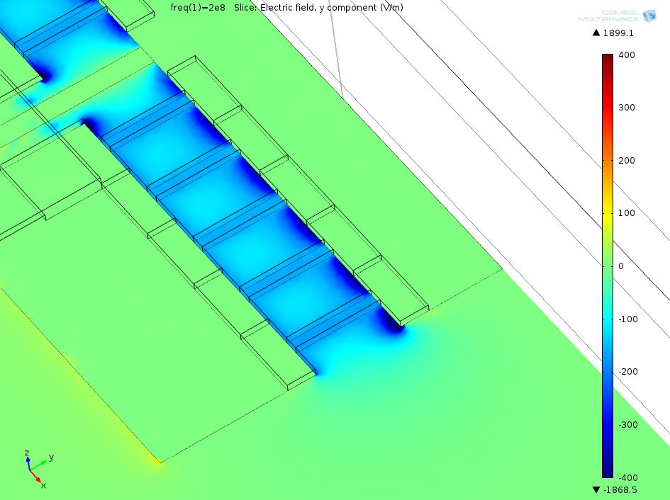

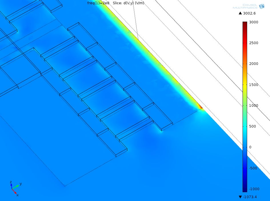

I have attached screenshots of d(V,y), and Y component of E field, respectively, plotted in the same plane. From my understanding, these should be equal, which is clearly not the case in my simulation.

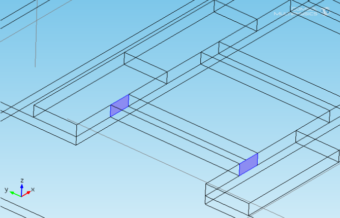

I have now run simulations at 1kHz and 10Mhz with boundary probes measuring average voltage on each end of a resistor. At 1kHz the difference is 0.83V, and at 10Mhz, it is -0.024V... Meanwhile, integrating the electric field over the length of the resistor gives 0.1V at both 1kHz and 10Mhz. So this confirms the slice plots in the PDF I attached earlier.
I have marked the boundaries that i probed for the voltage measurement in the attached image.
Strange! And even if I made some mistake in the model, I don't see how that could make E field and V field not correspond... And to make things even weirder, the correct V field is actually appearing between terminal and ground, it just isn't dropping over the resistors!

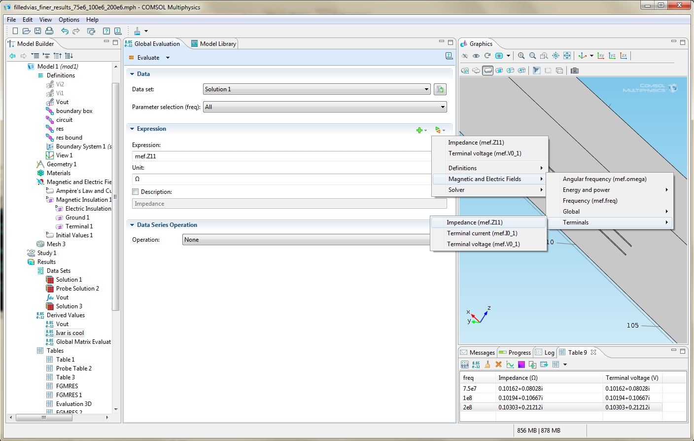

As far as I know, mef only gives acces to the terminal complex impedance - see attached screenshot.
At 200MHz, i get Ω = 0.10303+0.21212i, suggesting that the circuit is predominantly inductive.

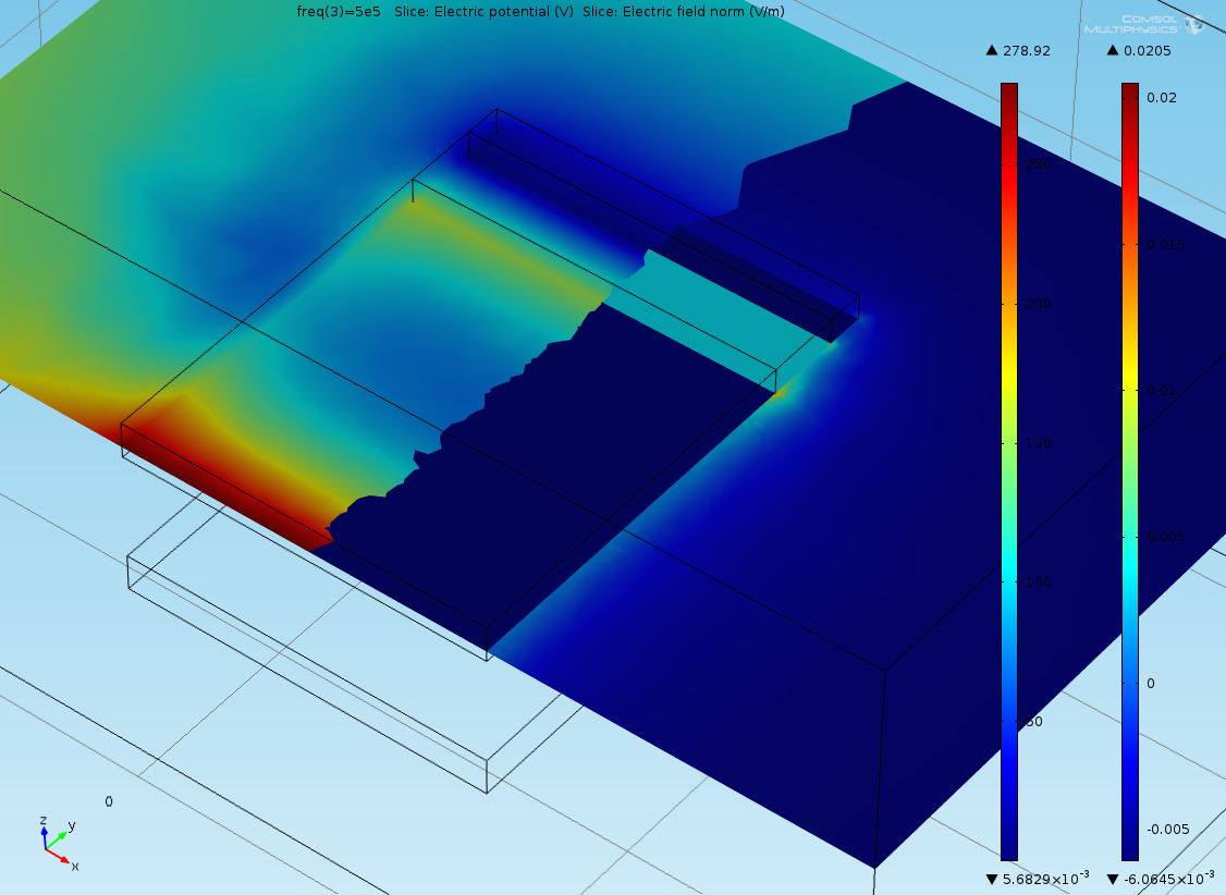

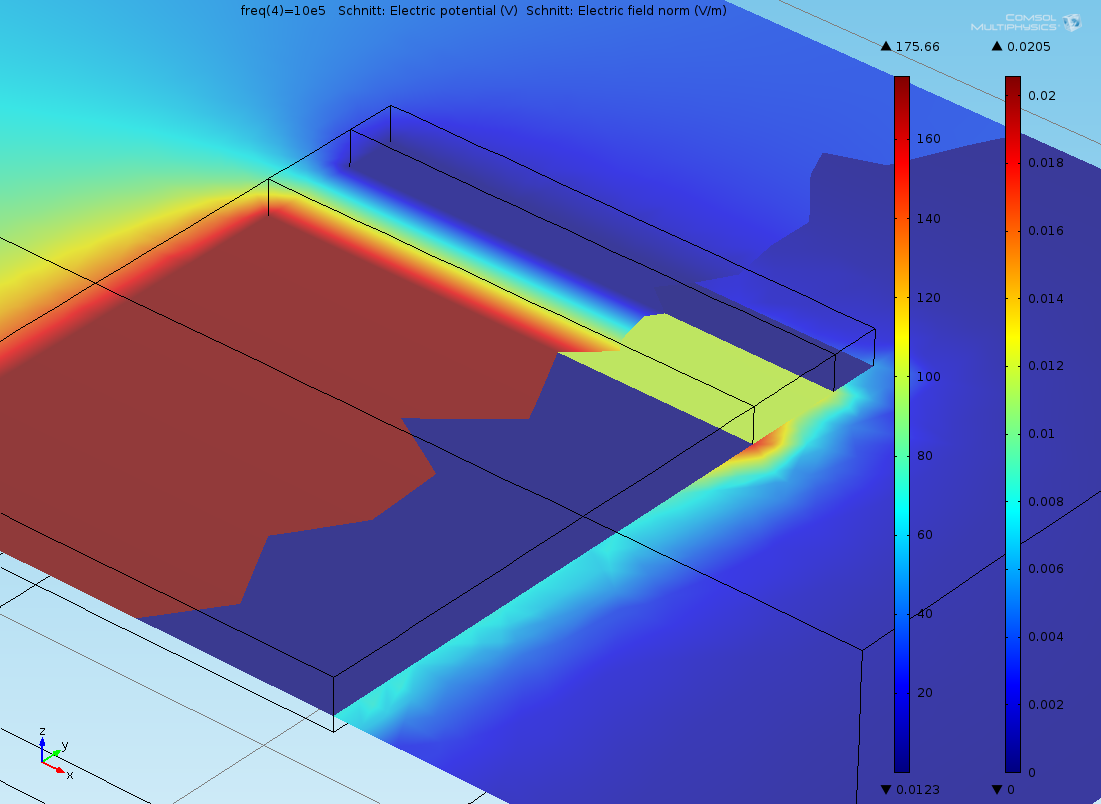

Posted: 1 decade ago 2013/05/05 8:33 JST
And here we go!
I made a simplified geometry, and the discrepancy between V and E persists!
Check it out, the attached screenshot shows a comparison of the V field and E field at 500kHz, made by applying complementary filters to the slice plots of V and E.
Also attached is the cleared model, it took 5 mins to sweep four frequencies on my workstation, but that is because I made the mesh quite fine in order to accurately resolve the skin depth (I wanted to rule this out as a possible cause). You can just change to a fine physics derived mesh and it will run much quicker, with not much different results.
Looking forward to hearing what you think :)
And here we go! I made a simplified geometry, and the discrepancy between V and E persists! Check it out, the attached screenshot shows a comparison of the V field and E field at 500kHz, made by applying complementary filters to the slice plots of V and E. Also attached is the cleared model, it took 5 mins to sweep four frequencies on my workstation, but that is because I made the mesh quite fine in order to accurately resolve the skin depth (I wanted to rule this out as a possible cause). You can just change to a fine physics derived mesh and it will run much quicker, with not much different results. Looking forward to hearing what you think :)
