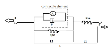

Posted: 1 decade ago 2013/04/24 12:50 JST
Hi Ivar,
I have tried modeling the 3 element Hill Model for muscle fibers (the image is attached below). I am using a simple geometry of a muscle fiber as a cylinder. I was able to set damping and spring constants to the geometry, but I am unable to ensure that this is actually a spring and a damper in parallel. For the series spring I was thinking of adding a thin elastic layer to represent this. I am trying to show correlation between a fixed force and displacement over a period of time. I have attached an image of the equation used for the Force, although I plan to set the force to a constant 500N. I am unsure about how to represent this COMSOL. The displacement seen in my model seems incorrect. Please Advise any input.
Shoaib Ahmed
Hi Ivar, I have tried modeling the 3 element Hill Model for muscle fibers (the image is attached below). I am using a simple geometry of a muscle fiber as a cylinder. I was able to set damping and spring constants to the geometry, but I am unable to ensure that this is actually a spring and a damper in parallel. For the series spring I was thinking of adding a thin elastic layer to represent this. I am trying to show correlation between a fixed force and displacement over a period of time. I have attached an image of the equation used for the Force, although I plan to set the force to a constant 500N. I am unsure about how to represent this COMSOL. The displacement seen in my model seems incorrect. Please Advise any input. Best, Shoaib Ahmed
Posted: 1 decade ago 2013/04/24 18:39 JST
spring and damper to a fixed reference is the "Spring" BC, thin layer physics really only appear between two domains. In you case the spring and damper is also distributed in the domain, so its whatever lienar or non linear structural physics to which you ad damping via a sub node
Hi spring and damper to a fixed reference is the "Spring" BC, thin layer physics really only appear between two domains. In you case the spring and damper is also distributed in the domain, so its whatever lienar or non linear structural physics to which you ad damping via a sub node -- Good luck Ivar
