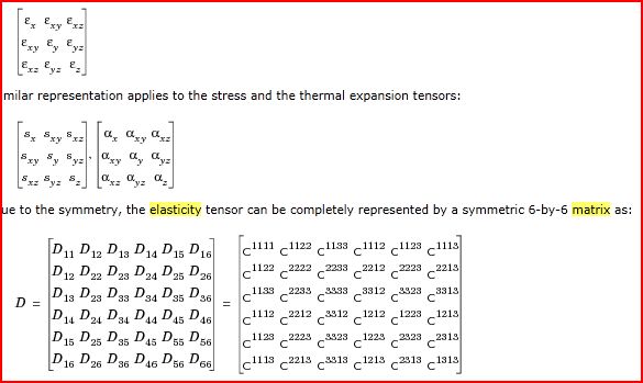

have you tried to define the material as anisotropic , in the physics node ?
Yes, I did. but the anisotropic elasticity matrix still assumes symmetrical tensor. What I need is to define all the elements separately.
for example in my case s12 is not equal to s21.
Thanks
36 elements for elasticity matrix still gives us 6 elements of the symmetrical stress tensor.
For a 3*3 stress tensor, I need to define all 9 elements separately. in my case s12 and s13 is not equal to s21 or s31.
Do you think that it is possible to define s21 or s31 or s32 in the equation view?

Just select "Equation View", then you can input directly all 36 elements of the elasticity tensor with whatever you want.
You are right, hadn't fully noticed that, and internally it stores only the half of the elements (check the equation view)
You can certainly define them, but then you must enter their values all over in "all" formulas,
The way rebuild your fully anisotropic physics with the "model builder" but that would take some time (I still havent manage to find enough time to learn that feature of COMSOL)
Other way ask support ;)
A material with unsymmetric stress tensor ("Cosserat elasticity") is rather uncommon, and cannot be modeled using the built-in functionality in COMSOL Multiphysics. All operations assume a symmetric stress tensor.
You can implement it on your own, using either the Physics Builder (as suggesteed by Ivar) or just weak form PDE:s.
There is a paper written about such an implementation:
Jena Jeong and Hamidreza Ramezani: Implementation of the Finite Isotropic Linear Cosserat Models based on the Weak Form. (COMSOL conference 2008)
www.comsol.com/papers/5073/

People have model Cosserat materials in COMSOL (I haven't personally), I believe it needs to be done at the PDE level. See. APPLIED PHYSICS LETTERS 94, 061903 (2009)
good luck, and let us know if your successful.

Thank you all for your comments
PDE interface doesn't work in my case, since I need to have the "floquet boundary conditions" on my model and it is not defined in PDE.
Based on your comments I think the Physics builder is the only remaining choice, I searched for that but I didn't find any example and seems too complicated for me.
Actually you can still build on Solid Mechanics. Just do the following:
1. Add one Solid Mechanics and one PDE physics interface.
2. Use the same degree of freedom names in both (u,v,w)
3. Set Young's modulus to zero in Solid Mechanics so that there is no stiffness contribution.
Now you can use all loads and boundary conditions (including the Floquet conditions) from Solid Mechanics. Your PDE interface only needs to implement the material model replacing Linear Elastic.
An alternative is to not add the PDE physics interface at all. Just define all your variables, and add a weak contribution under Solid Mechanics for the internal virtual work. You can also reuse some of the variables like parts of the strain, since they will be defined by the Linear Elastic feature.

Hi Henrik
many thanks for your comments
On your first approach:
1- COMSOL doesn't allow me to have similar names for dependent variables of two interfaces:
I tried to define the PDE's degrees of freedom (u2,v2,w2) as variables equal to (u,v,w) of (elastic wave interface)
However, I have no idea which one is correct: (u,v,w)=(u2,v2,w2) or (u2,v2,w2)=(u,v,w)??!!
2- should I use the same study for both and couple both? or I need to solve the PDE first?

Hi Alireza,
As it seems that the second approach is the easier, I will focus on that.
1. By setting E=0 in Linear Elastic, you will suppress the whole contribution to the virtual work from the stresses (=the stiffness matrix). The contribution to the mass matrix is still generated, though.
2. All nine components of your stress tensor will need to be defined as variables. So will also 'strain' variable like Cosserat stretch and curvature.
3. Make sure that Show->Advanced Physics Options is selected.
4. At the domain level add More->Weak Contribution.
5. In the Weak expression, fill in the complete virtual work expression for the Cosserat material. The syntax is just as the one you see in equation view under Linear Elastic, i.e. a sum of terms like
my_stress11*test(my_strain11) + ...
6. You can add several Weak contribution features and split the weak contribution into several terms to improve readability. The number of terms in the Cosserat formulation is rather large, since there are the curvature terms as well as the unsymmetric tensors.
It may be possible to keep the Linear Elastic contributions, and only add the 'additional' terms in your own weak expressions, but that will probable be more obscure.
Henrik

Great,
Thank you for your advice!!
I searched for the matrix exponential using comsol and matlab and I looked over this post in the comsol forum!!!
I read this subject about non-symmetric stress tensor issue. As pointer earlier, this issue has been successfully done using General Weak PDE. There is a bunch of papers about the Cosserat theory (large and small deformation) and it is not new at all.
The unsymmetrical stress tensor implies the solution of another equilibrium equation in the solids mechanics...
Hence, you have to solve these equations at the same time...
\Div \sigma + \rho b=0
\Div m + \rho c-e:\sigma=0
m= stress moment in the Cosserat theory....
Google it, cosserat, comsol, jeong, neff, ramezani and you can find out more about it...
The main questions are :
1. Why do you have the unsymmetrical stress tensor?
2. What is your additional equilibrium equation?
As far as my knowledge, the unsymmetrical stress tensor can be exclusively seen in the generalized continuum mechanics and chiral media.
Hope that this was helpful!
Regards
Hamidréza
