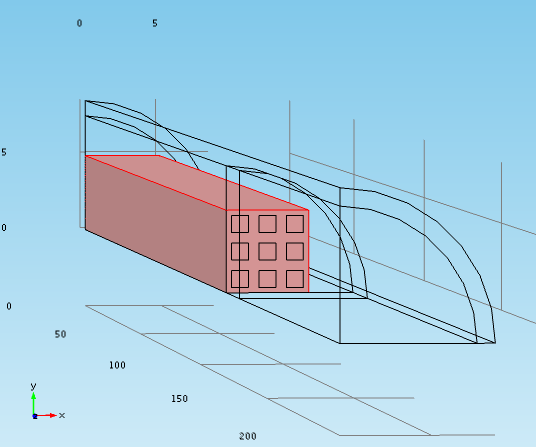

i'm studying heat transfer in a pipe where there is a SiC monolith surrounded by an insulating mat (see screenshot).
Up to now I have studied the system considering the monolith as pure solid using for my model only the Conjugate Heat Transfer physics.
Do I have to change physics to consider the monolith as porous?
If yes how have I to set the domain in the new physics?

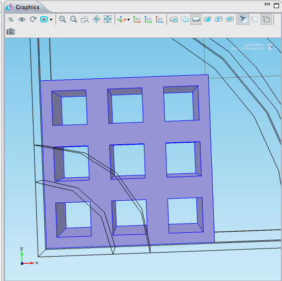

I'm trying to use the Darcy or Brinkman equations to simulate the flow through my porous monolith, but I haven't fully understood how these physics work.
First of all I don't know how to say that in one domain (see image) there are 2 different materials. This domain is the porous solid of SiC.
I want to simulate the air passing first in the pipe and later both in the free channels and in the porosity of the solid.
Thank you for your reply.
I'm trying to use the Darcy or Brinkman equations to simulate the flow through my porous monolith, but I haven't fully understood how these physics work. First of all I don't know how to say that in one domain (see image) there are 2 different materials. This domain is the porous solid of SiC. I want to simulate the air passing first in the pipe and later both in the free channels and in the porosity of the solid. Thank you for your reply.
